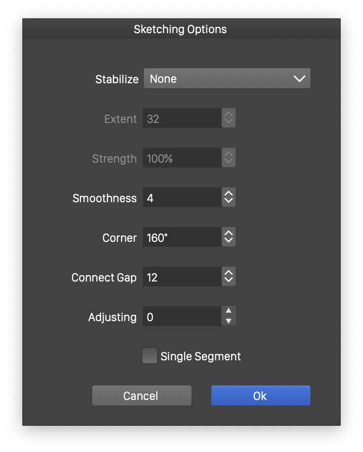

The Path Sketch tool options.
Path Sketching Options
The options controlling various aspects of the Path Sketch tool can be adjusted by double clicking on the tool icon in the application toolbox.
The following options are available:
- Stabilize - Select the pen path stabilization scheme used while drawing with the sketch tool.
- Extent - Set the size of the pen stabilization window.
- Strength - Set the strength of the pen stabilization.
- Smoothness - Set the smoothness of the resulting path. The path is created by approximating the locations traversed by the brush paint using the minimum number of curve segments.
- Corner - Set the minimum corner angle, above which the intersection locations are smoothed out.
- Connect Gap - Set a maximum gap (in screen points) between closest locations of two shapes, when merging still occurs.
- Adjusting - Set the number of previous attempts of sketches when redrawing the last sketch while holding the Option (Mac) or Alt (Windows) key.
- Single Segment - Check to create single segment at each sketching swipe.
