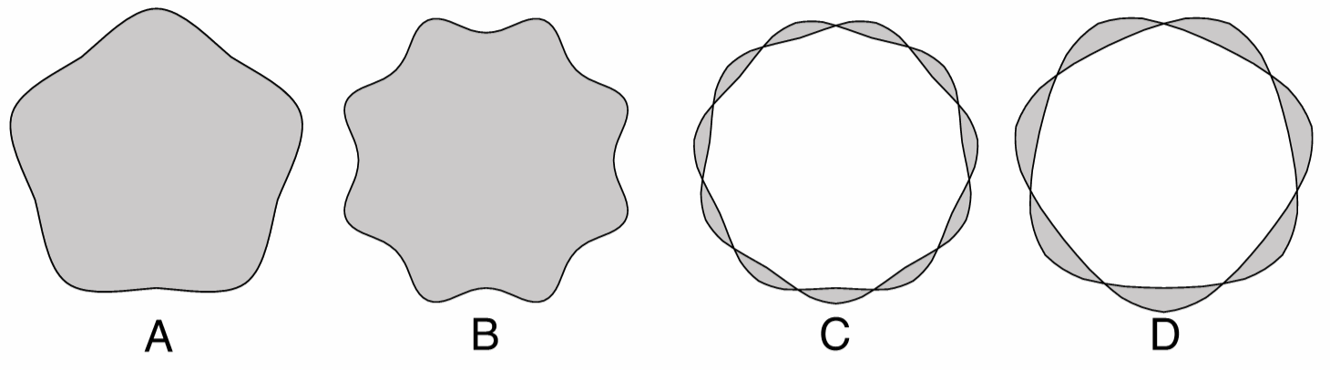

The super shape is a generalized shape that extends the super ellipse to arbitrary sides using additional parameter, to generate complex shapes. Super shapes can be used as object shapes, or building blocks for more complex shapes.
The properties of a super shape can be edited using the Node tool or the Shape panel.
Super shapes with different properties: (A) a 5 sided super shape, (B) an 8 sided super shape, (C) a super shape with 5.5 sides, (D) a super shape with 3.5 sides.

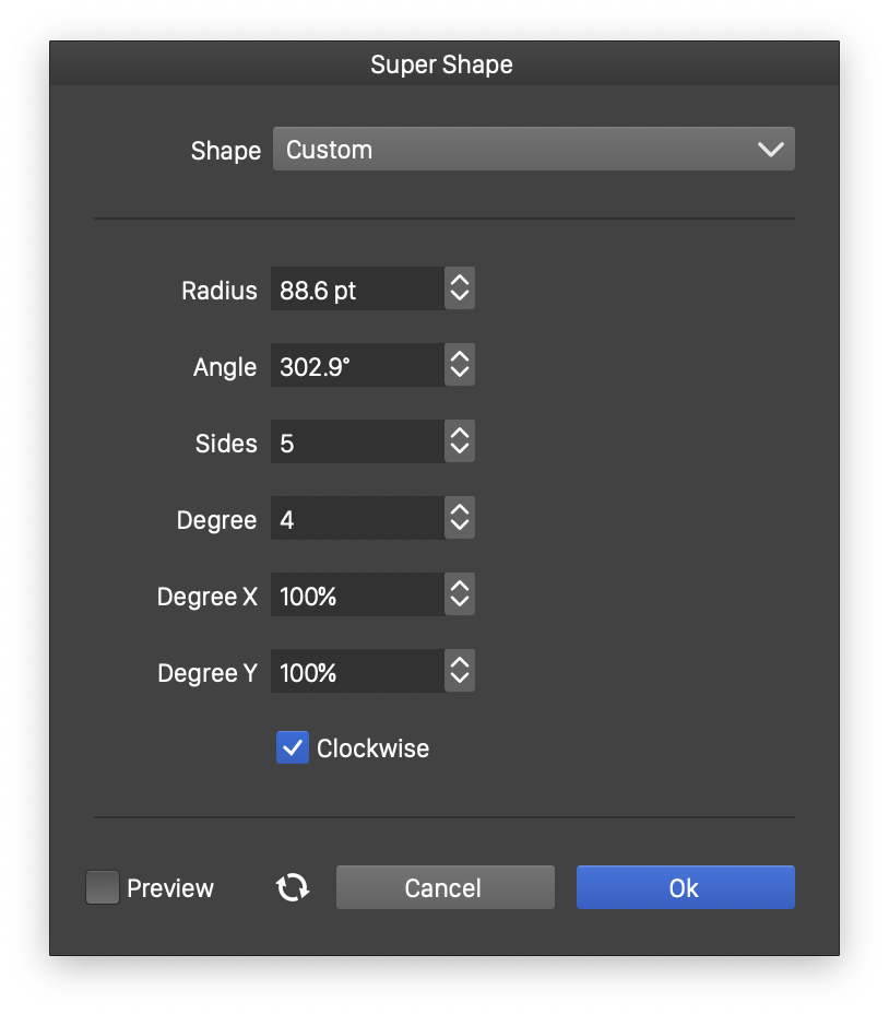

To create a super shape by setting the numeric properties of the shape, click at a point on the canvas. This will open the Super Shape view (described below) that contains all the super shape properties. Set the required values and press Ok to create a new object with a super shape.

The Super Shape view.
The properties of a super shape can be edited in the Shape panel when the shape is selected, or in the Super Shape view, either from the shape panel, or when editing a shape style.
The following properties can be modified for a super shape:
- Radius - Select the radius of the super shape.
- Angle - Select the rotation of the super shape.
- Sides - Select the number of sides of the super shape. The super shape side is a fractional number. When it is not an integer, the super shape is looped until an integer amount if sides is reached.
- Degree - Select the degree of the super shape. The degree controls the curvature of the super shape sides.
- Degree X and Degree Y - Adjust the super shape degree in horizontal or vertical direction, creating shape variations.
- Clockwise - Set the super shape direction to clockwise or counter-clockwise. The shape direction can be observed with the Node tool after converting the super shape to curves.
