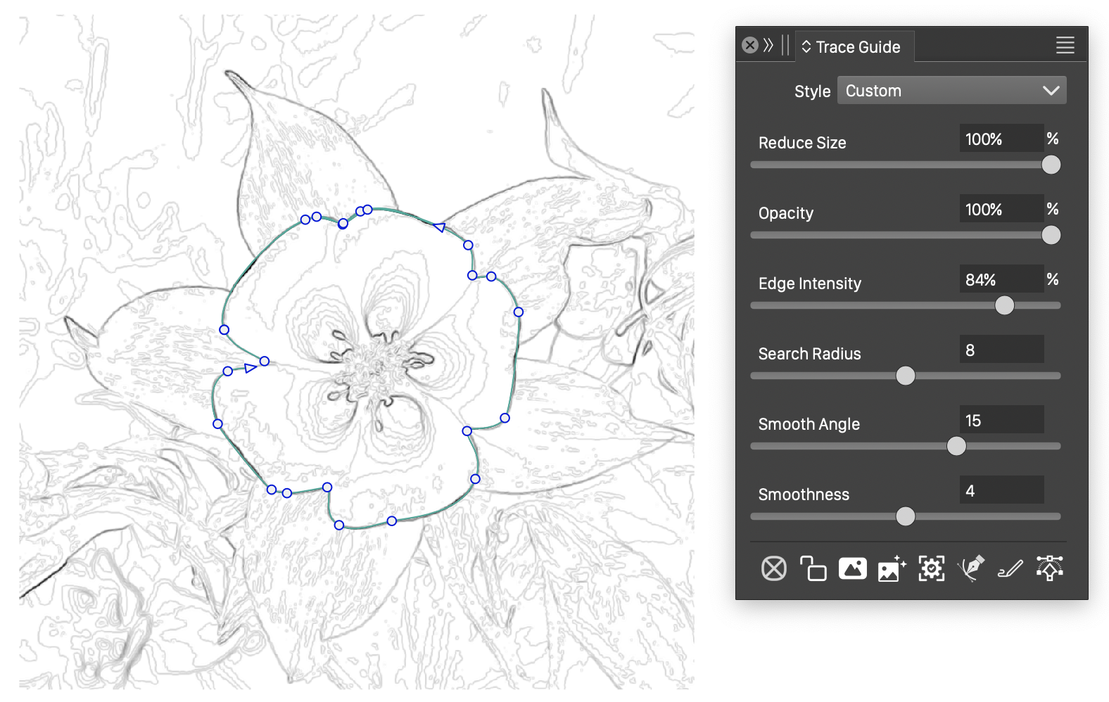

An edge highlighted image with the Trace Guide panel and the trace tool activated.

- Adjust the Edge Intensity field to limit the level of tones for location where edges can be extracted from.
- Click with the Image Trace tool at a location of the image where the edge extraction should start (should be a location with a dark tone). The mouse is released after this click.
- Move the mouse to another spot on the image, that is connected with the first click location with a dark edge.
- As the mouse is hovered over the image a red highlight indicates the shape that can be extracted. To be able to extract the shape the new and previous locations should be connected with a dark edge.
- Click with the mouse again to add a new section to the extracted shape along the highlighted edge.
- Repeat this process of clicking at edge locations to create a shape along an edge.

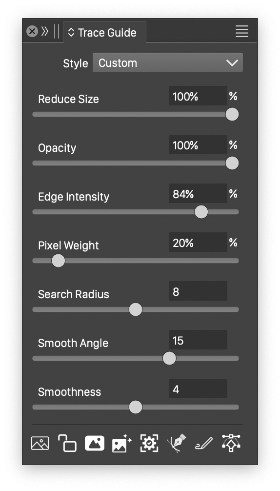

The Trace Guide panel
The Trace Guide panel used to manage the edge extraction and display options of images traced with the manual image trace tool.
The trace guide options consist of an image edge highlight filter and a set of options controlling how the shapes are extracted from the edge highlighted image.
The edge highlight (or Trace Guide effect) filter is documented in the Image Effects chapter.
The Trace Guide panel.
The following options are available in the trace guide panel:
- Style - Create or select trace guide styles and presets.
- Reduce Size - Reduce the image size to speed up the edge highlight filter. Used for large images. It is also useful for images that do not need the edge highlight filter (for example outline sketches) to reduce sketching width so that the extracted shapes are better defined.
- Opacity - Sets the opacity of the image in edge highlight display mode.
- Edge Intensity - Sets the maximum intensity of a pixel used to extract shapes from (small values are dark, large values are white pixels). Used to restrict the possible route a path can take when extracting shapes. Smaller values may result in gaps that cannot be automatically connected.
- Pixel Weight - Set the balance between the number of pixels a shape traverses and the intensity of these.
- Search Radius - Sets the radius of finding the right intensity around the mouse position.
- Smooth Angle - Sets the curve extension smoothing angle.
- Smoothness - Sets the extracted shape smoothness.
- Sweep Width - Sets the width of the region when extracting shapes by painting over the image.

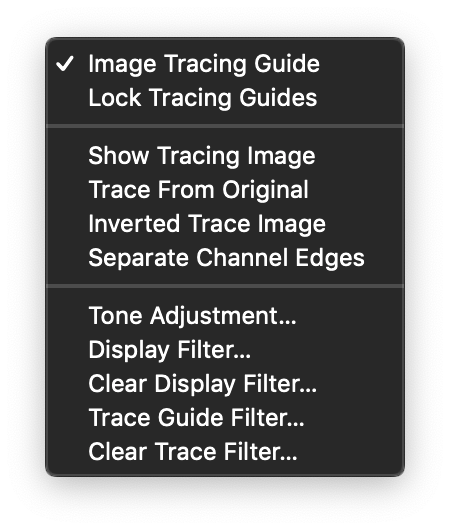

The Trace Guide panel menu.
The Trace Guide panel menu contains the following commands:
- Image Tracing Guides - Show or hide the edge highlight mode of the images.
- Lock Tracing Guides - Lock or unlock all the guide images on the current canvas.
- Show Tracing Image - Show or hide the traced image.
- Trace from Original - Do not use the edge highlight filter and extract shapes from the original image. Suitable for hand drawn sketches and outline drawings.
- Inverted Image Trace - Invert the image used for edge extraction.
- Separate Channel Edges - Check to extract edges separately from each color channel and combine the result by selecting maximum edge intensities. By default, edges are extracted from a gray scale version of the image and for some color combinations the edges may not be present in the gray scale version.
- Tone Adjustment - Edit a tone adjustment curve for the edge highlight image, to control the contrast of the edges.
- Display Filter - Edit the image filter used to display the edge highlight.
- Clear Display Filter - Remove the edge highlight filter.
- Trace Guide Filter - Edit the image filter applied to the edge highlight before extracting shapes.
- Clear Trace Filter - Remove the edge processing filter.

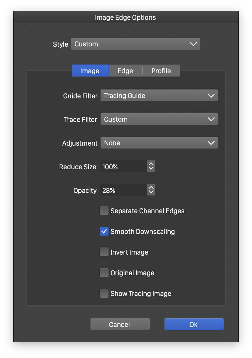

The following options are used to find edges:
- Guide Filter - Create, select or edit an image filter used to highlight edges.
- Trace Filter - Create, select or edit an additional image filter used to extract edges (not for display).
- Adjustment - Apply an adjustment curve on the resulting edge image to improve the contrast of edges.
- Smooth Downsampling - Use a smooth downscaling method.
- Invert Image - Invert the image used for edge extraction.
- Original Image - Extract edges from the original image without using the edge highlight filter. Suitable for hand drawn sketches and outline drawings.
- Show Tracing Image - Enable the display of the additional edge tracing filter (if defined).

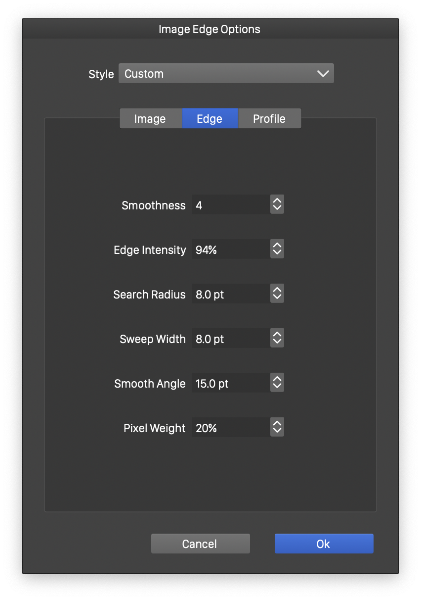

The following options are used to create shapes from edges:
- Smoothness - Set the smoothness of the resulting shape.
- Edge Intensity - Sets the maximum intensity of a pixel used to extract shapes from.

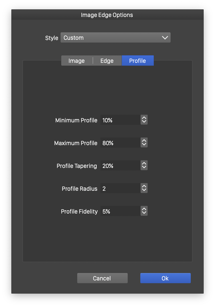

The following options are used to extract stroke width profiles from edges:
- Minimum Profile - Set the minimum edge intensity for profile extraction (resulting in minimum profile width).
- Maximum Profile - Set the maximum edge intensity for profile extraction (resulting in maximum profile width).
- Profile Tapering - Set the amount of tapering applied to the variable width profile.
- Profile Radius - Set the radius in pixels to search for the edge width at a location.
- Profile Fidelity - Set the width profile simplification factor.
