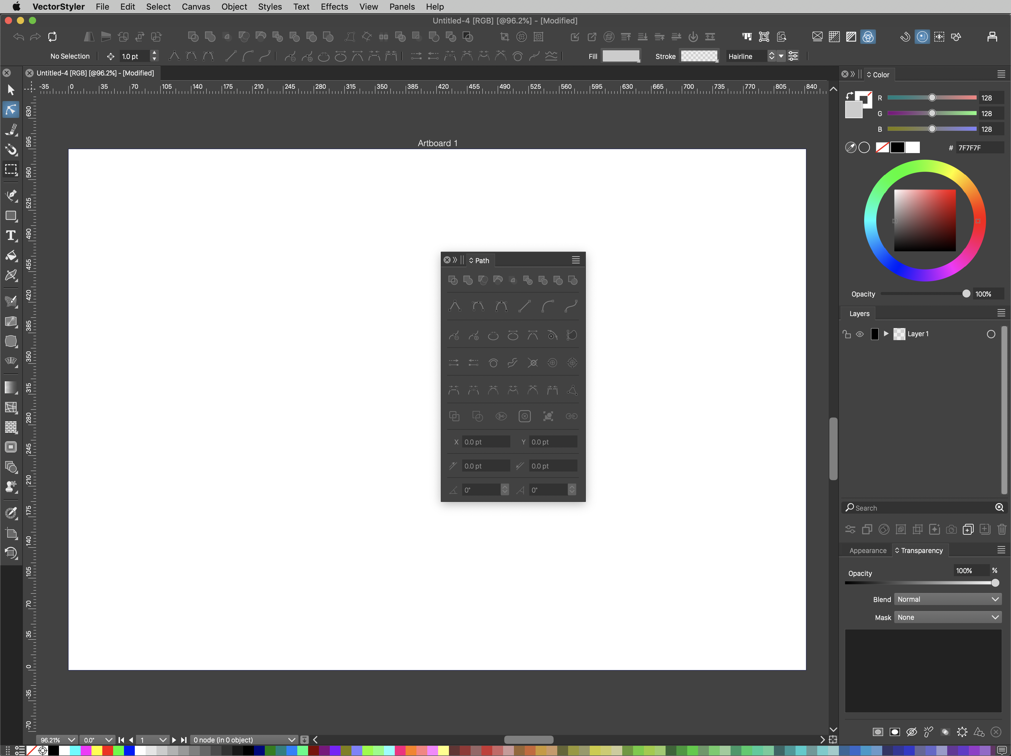

The VectorStyler main view with an empty document.

The Workspace of VectorStyler consists of all the direct and indirect settings and status information describing the placement and access to various application features. These include not just the panel arrangements, but also toolbox, application menu, contextual menus and shortcut customizations as well. Most of the panel (but also modal view) status information are also persistent, and are stored in the workspace file of the application. Default settings, attributes in some panels and views are restored to their last state after application restart. The positions and size of modal views are also persistent, views will be opened at their last location with their last size (if resizable).
The first and most common workspace customization step is the selection and arrangements of various panels required to create a design. Most of the panels are accessible from the Window menu, and can be opened, closed and placed at arbitrary locations around the screen, or docked into the application window.
The Workspace also contains all the implicit states of various interactive editors like shape drawing or the distortion brush tool. For example, the number of sides used in the last polygon drawing will be the next one also.

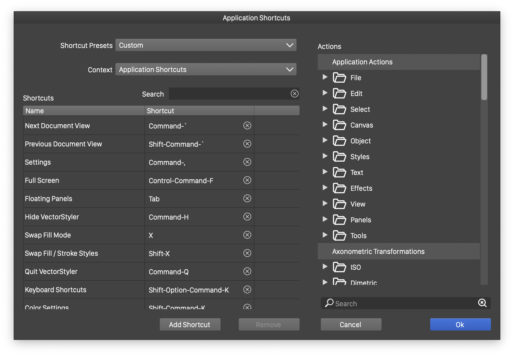

The shortcut customization view.
The Workspace contains the current shortcut settings. Shortcuts can be customized using the Keyboard Shortcuts command from the application menu. A customized shortcut assignment can be saved into a separate file and recalled later from the shortcut customization view. Since the current shortcut assignments are also stored in the workspace, swapping the workspace will result in changing the shortcut assignments as well.
