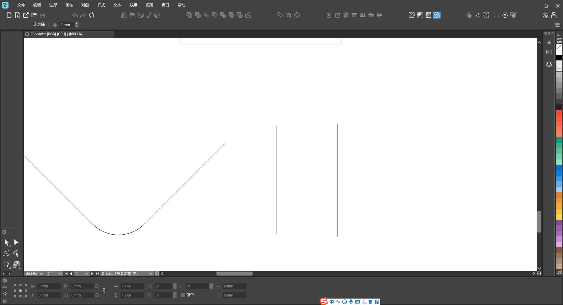

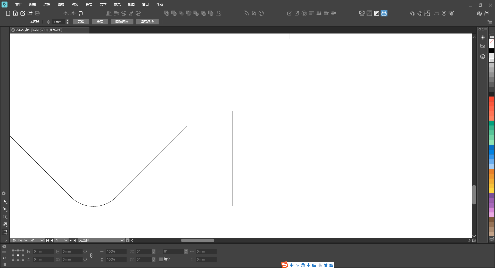

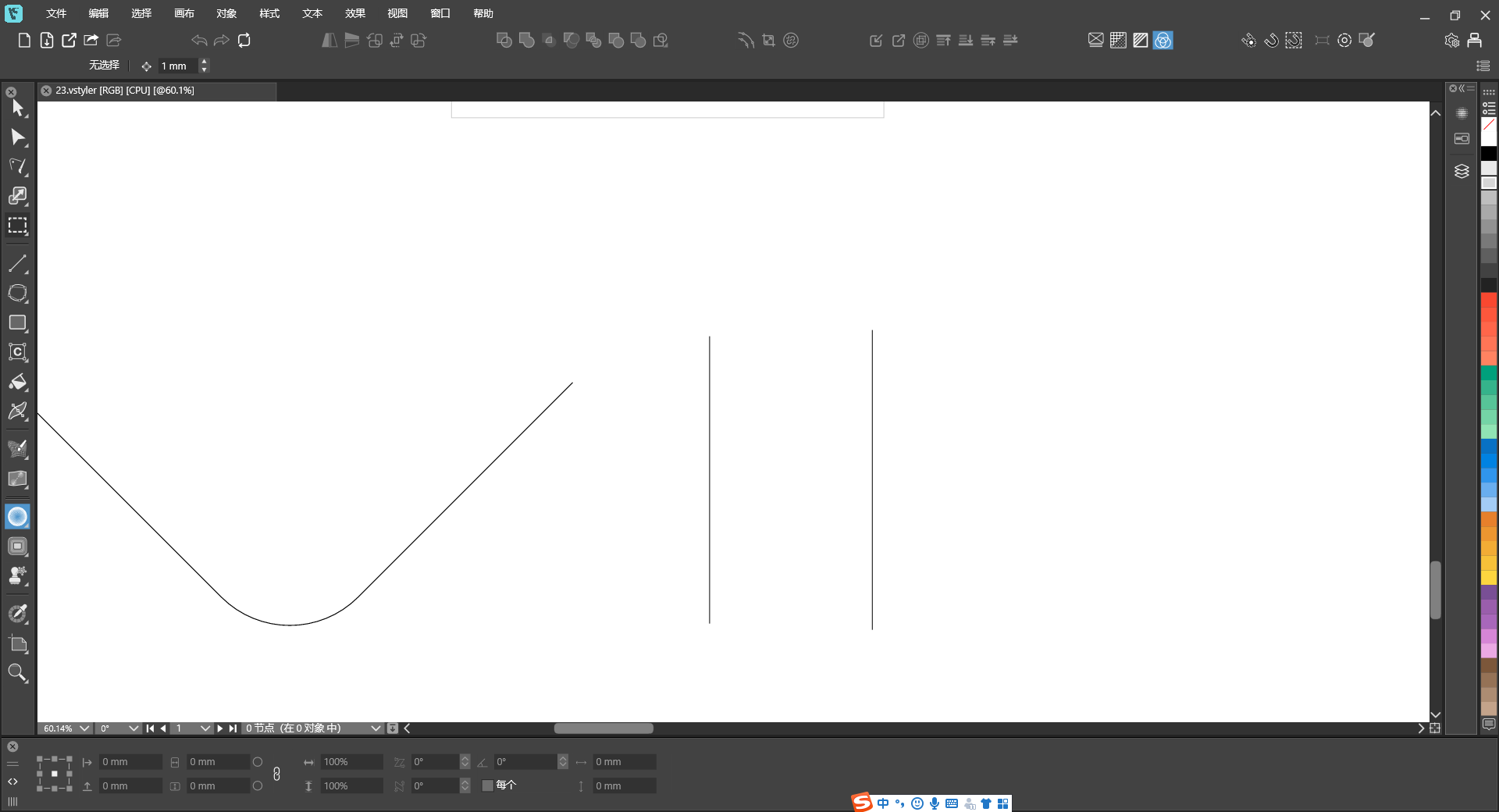

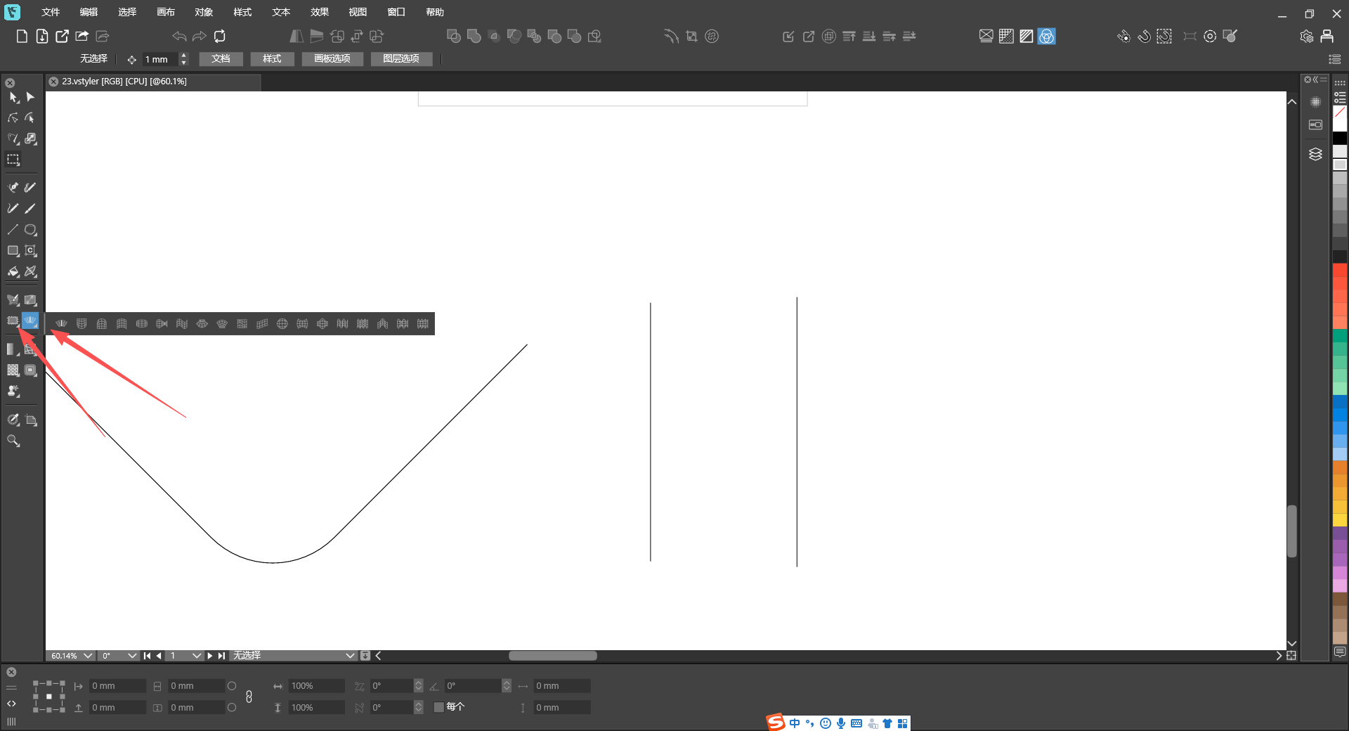

                                        monsterfox @VectorStyler
                                        @VectorStyler https://youtu.be/SLNsOzXtN9w
                                        When switching the layout of the selection toolbox, some tools go missing and the full set of tools cannot be displayed properly.
                                          VectorStyler @monsterfox
                                          @monsterfox If you change the window size, will it reset the layout?
                                          • M Offline
                                            @VectorStyler No. Sometimes even restarting the program has no effect.
