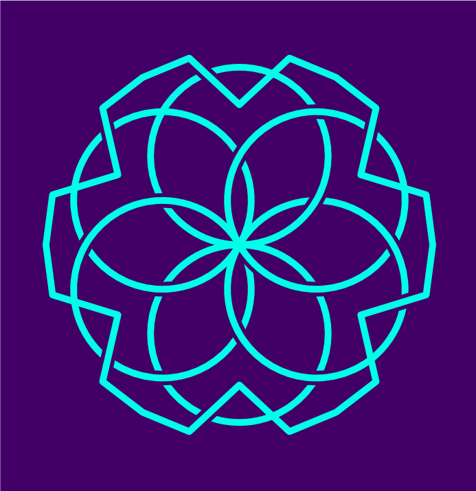

      Is it possible to allow intertwine to work on pure blacks. Please see the knot path effect in Inkscape. That's what I am looking for. But in Inkscape, the knots don't follow the path direction, so they lead to very jagged edges. See what I mean?

            @Subpath: Nope. Very similar problem. Leading to strange distortions.
            Even in your example, you can see what the problem is: The gap does not follow the path. 😭

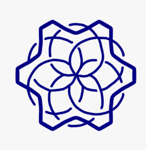

                  @Subpath: This too failed eventually. Getting the gaps to follow the direction of the path was difficult. I did however manually complete the project.
                  It's for an AI-based security firm. The central pentagon stands for the SOC, the security operations centre. The circles on the outer perimeter represent the constant social listening of the AI engine. The interlocking lines show unending stream of data. The filled blue hexagons represent co-ordination and continuous monitoring. Sort of like a beehive. 🙂 Wanted to share because the client was chuffed and I was very excited.

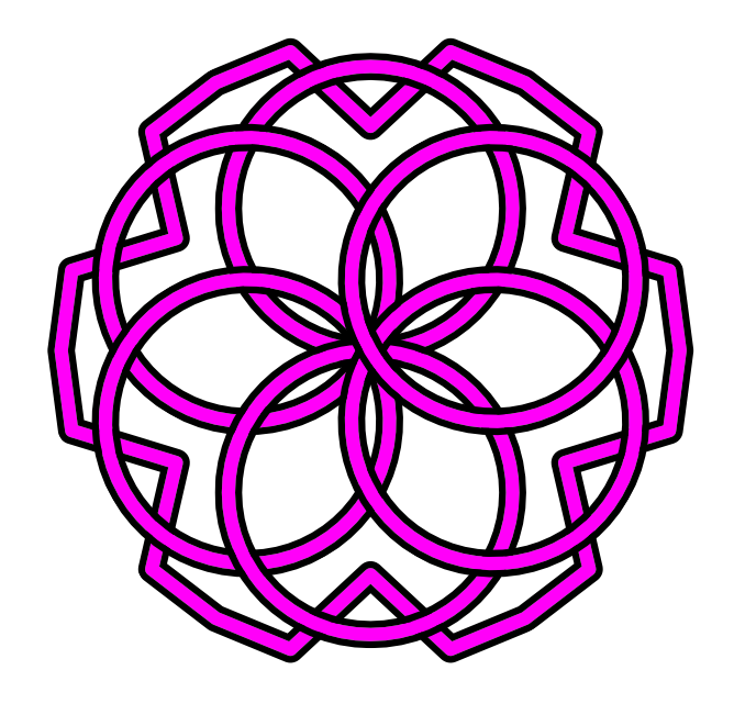

                                  While our developer is working the intertwine and crossing gap function, I thought through a simple but very effective solution based on @Subpath's suggestion, which might be useful to others who want create intertwine effect perfectly.

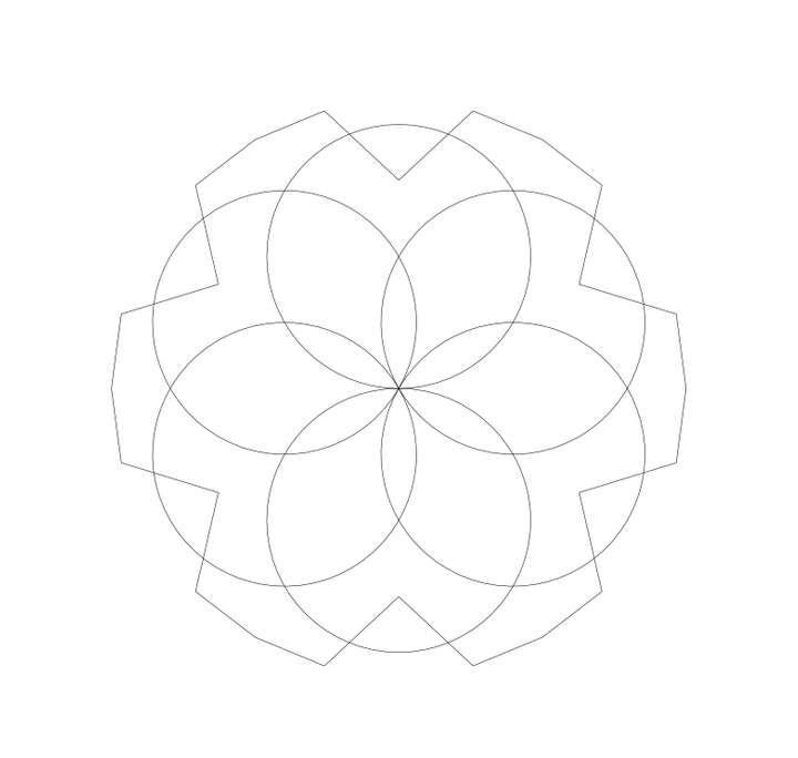

                                  First, sketch out your idea:
                                  Mark out alternating sections of above and under for the knotting.
                                  Then create your vector shape. 0_1766151144714_3012e868-1cbe-47cc-9a7d-c56db49a7df7-image.png

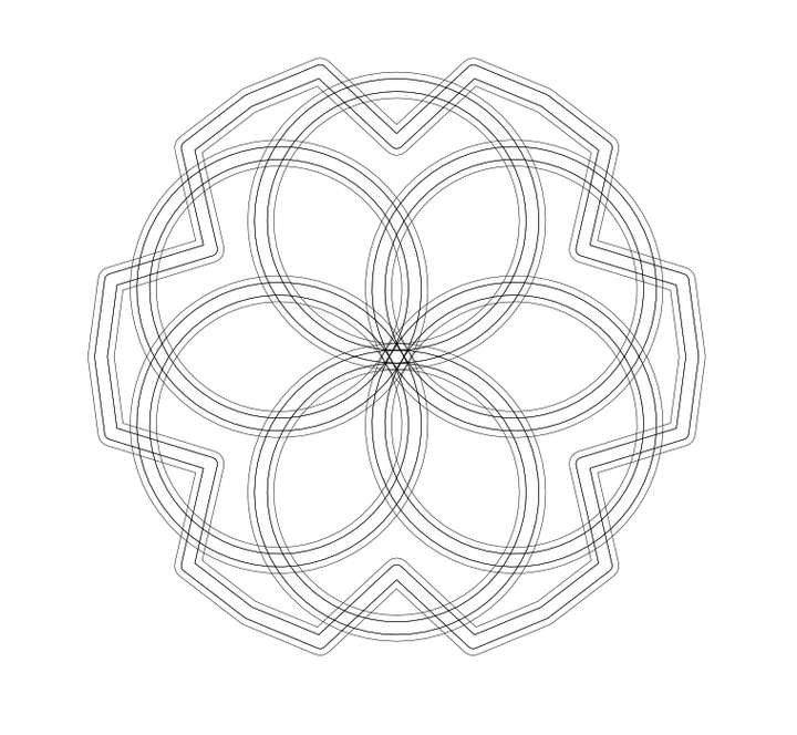

                                  Then, expand the stroke:
                                  Then apply a stroke to the expanded shape.
                                  Then expand the shape again. Now you'll have two set of expanded strokes.
                                  Now, use the shape builder and cut out the under portions of the knot. You'll be left with the desired result.
