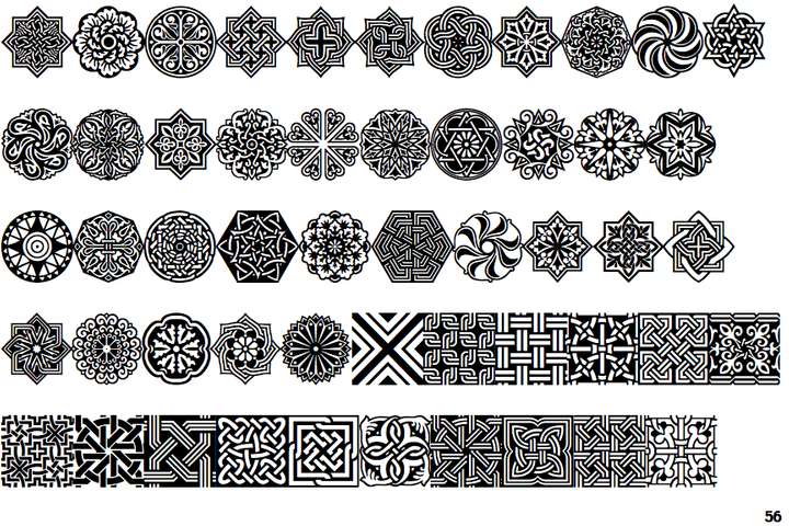

@Boldline: if you want inspiration for some very intricate knotting patterns, look up Henman Pictogram font 2.
I just wanted to let you know that @VectorStyler is already working on the problems with the "crossing gap" shape effect.
It is already mentioned in the top region of this thread. -
WOW !!!
Thats a lot Variations. -
