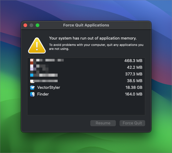

Since I upgraded to Build 28, I've been seeing frequent situations where my application memory used by VS is incredibly high. I'm not sure what's causing it as I'm working on one or two VS files at a time and not doing anything different than other times I've used VS prior. This was also occurring yesterday as I worked. The second screenshot was after i quit VS and started working again. It was climbing back up consistently
@Boldline How long was VS running when reached this memory.
I will try to replicate this, but it might be task dependent.
It starts to build almost immediately after I open a fresh VS and start working. I did not check to see if it's related to a brand new file or only for files that are existing prior to the new VS session. I will test that next.

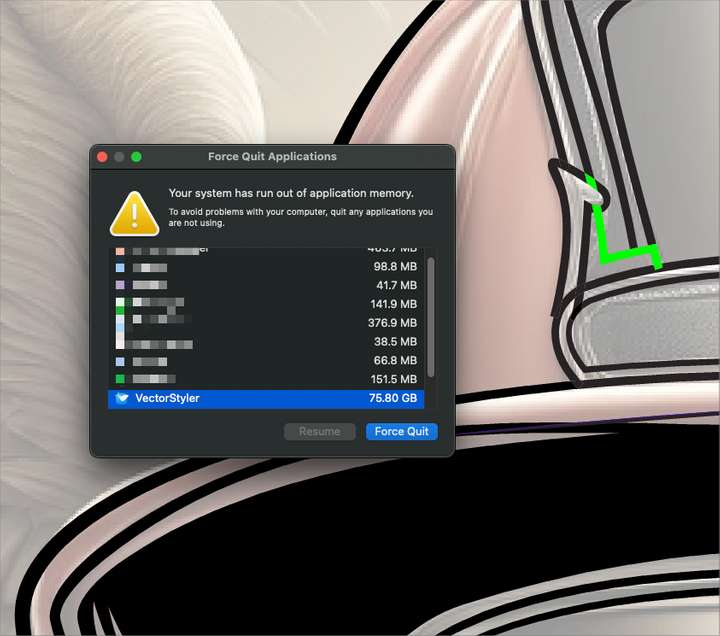

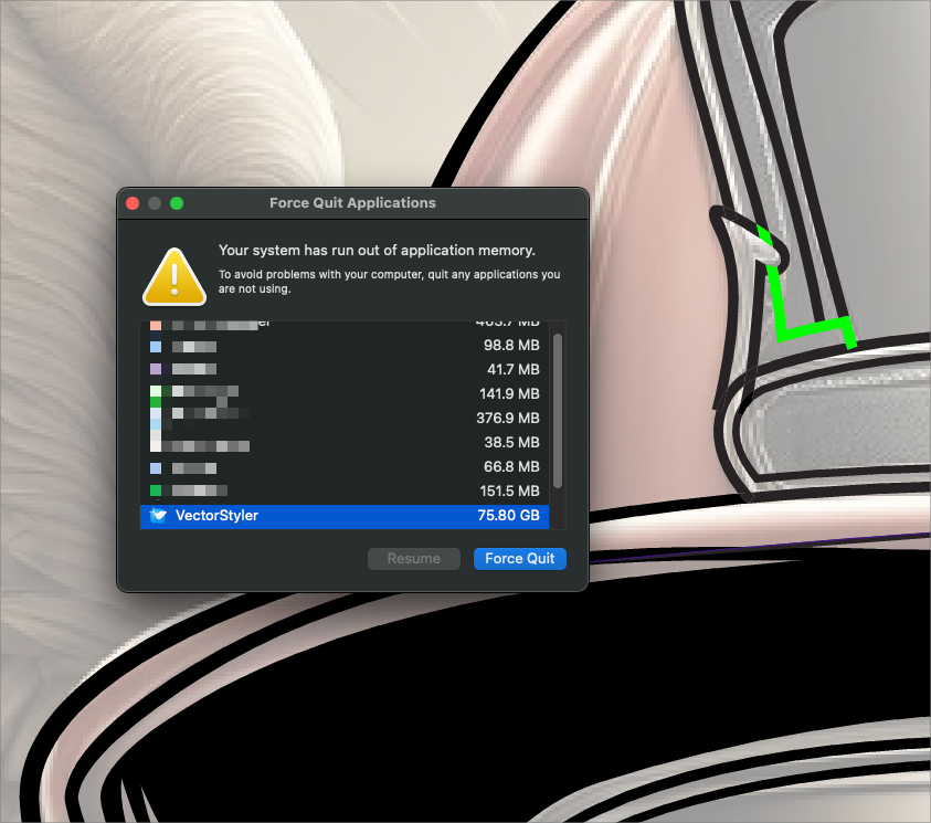

With an existing file, it took 15 minutes for it to climb up to 5GB of RAM. Sometimes it would hold steady or decline slightly, but then it would methodically keep climbing. By the time I've been working for an hour or two, it's at 75-80BG and the force-quit warning panel appears

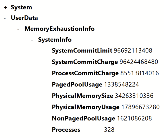

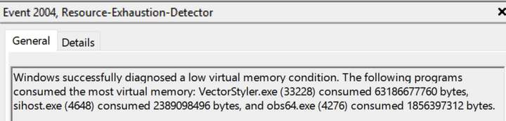

It may or may not be related to @Boldline's issue, but I had a blacking out of the application canvas (like video failure/Black Screen of Death-ish). I didn't know the cause at the time but I noted later in Event Viewer a few of these kinds of entries for each of those events when the canvas blacked out.
"Windows successfully diagnosed a low virtual memory condition. The following programs consumed the most virtual memory: VectorStyler.exe (33228) consumed 63186677760 bytes, sihost.exe (4648) consumed 2389098496 bytes, and obs64.exe (4276) consumed 1856397312 bytes."
63186677760 bytes = 63.18GB
Note: RAM was not full:
MemoryExhaustionInfo
- SystemInfo
SystemCommitLimit 96692113408
SystemCommitCharge 96424468480
ProcessCommitCharge 85513814016
PagedPoolUsage 1338548224
PhysicalMemorySize 34263310336
PhysicalMemoryUsage 17896673280
NonPagedPoolUsage 1621086208
Processes 328
- SystemInfo
