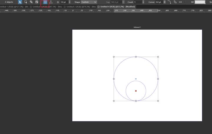

    snap indicators invisible
    replicate steps:
    1. draw 2 circles like the image below shows:(align the inner circle to the bottom center of outer circle)
    2. enable the transform pivot point editing by click the button in toolbar
    3. drag the outer circle's pivot point towards its bottom and snap indicators don't show, causing it unable to align the point with inner circle's center.

  • Tried to replicate this. The first one I can't replicate. And the second one I run in the problem that when I enabled the pivit point it doesn't appear. (I also tried it in the beta version, and there I don't see any problems, but thats not the version that you are using).
    Just a question which checkboxes do you have enabled in the snapping panel. Maybe you can make a screenshot of the panel.
    @Iriseg524 Thank you for the feedback. I also tried to replicate the issues, but could not so far.
    Your device setup is good, I'm testing with Windows 11 on a smaller one.
    For duplicate lag: I tested it on Windows 11 22H2, and there seems to be no problem. The performance settings do not affect the speed of a basic shape duplication and dragging (it is for image effects, gradients, etc).
    I don't have 23H2, but searching around the internet, there seem to be some posts about performance issues.
    As for the snapping issues, this did not replicate also, what are your snapping settings?
  • @VectorStyler Thanks for early reply.
    Here is the screenshot of my snap settings menu:
    As we can see, I enabled the "Snap to Objects", "Snap to points" option.
    Here are some additional info:
    I started trial of VS about 1 week ago and it was at version 1.1.113 when I noticed this issue.
    At the moment I can by chance trigger the snapping incicators by following steps below:
    1. save document and restart VS
    2. switch document view mode to outline view
    3. do the pivot point snapping
    4. the indicators work properly.
      However, though these are the steps, if I follow them, indicators will appear by chance; if not, they never appear.
      I did all of these with the same options shown in picture that time.

  • @Iriseg524 @VectorStyler The snapping issues cannot be reproduced in both versions, but a different problem arises in version 1.1.116. Please refer to the recorded video for more details.
    video
  • @Li-Xiao Thank you, avoiding continuously holding may be a temporary alternative solution. I believe the issue will be solved eventually as in Adobe Illustrator it works well(I come to VS from it so I'm trying to test as more as possibly every feature I know that works in AI).
    For snapping issue, few moments ago I tried to enable "Formation Snapping" option in the snapping panel and another form of indicator appeared and help me with aligning pivot point with the inner center. But I still can't see indicators appear in @Li-Xiao 's video.
