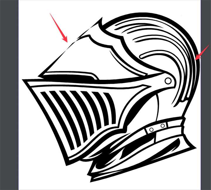

I'm running into an issue where the editing of nodes on one side of the design is negatively affecting the nodes on the other side. I have the setting on where a section can grab both the nodes and handles as well together - usually it's not an issue and I don't think it is in this case because the two sides are farther apart and I don't see any super long handles that might interfere. Here is the video
Editing the nodes on the right side arrow affect how it looks on the left side.

@Subpath @b77 I appreciate you both experimenting with it. I probably did not explain it well enough. The issue is the kink on the right side... when you delete the extra nodes making the kink on the right side, it negatively affects the left side as a result. right side issue causes left side bad result. I think you were both doing it in reverse.

Steps to replicate the issue:
- open the file;
- undo once to get the bump back;
- zoom in on the right side;
- select the few nodes of the kink/bump;
- press Delete.
Video here: https://recordit.co/fHbd07MUDW

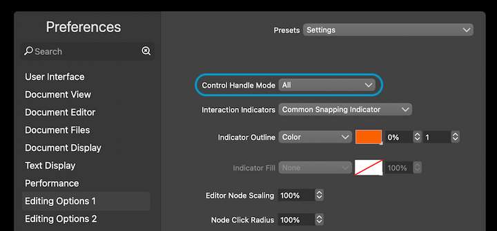

@VectorStyler Boldline said it happens if 'Control Handle Mode' is set to All:

@Subpath @Boldline @b77 The root cause of this problem was identified, and the fix will be in the next build.
When using the "All" mode in "Control Handle Mode", the selection made with the box selection will include control points also.
And this is not handled correctly by the delete node command.
