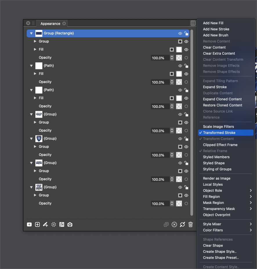

I'm trying to scale these designs and I'm getting issues because the stroke stays the same size even as I shrink the design. When I go into the appearance panel, I assumed going to the main top group that represents everything inside and changing it there would have a cascading effect on all the sublayers under it - this did not seem to be the case... so instead I need to go seek out any and every stroke I want to scale with the design and adjust them individually.... this does not seem like the most efficient way to do this...

The Transform Stroke option set on a group (or layer) works for all child objects also.
I add the default mode to the backlog.
@b77 I had not thought of that possibility - thank you for explaining. It's possible I might change my workflow to utilize that.... it's happened with many other things that were done differently in VS than I was used to lol
I got it to work now even when selecting the group it's contained in.

@Boldline One thing: if you enable "Transformed Stroke" in the options of the top layer, then all objects inside will have transformed stroke.

@Boldline There is also a "Transformed Stroke" option in Document Setup. This will affect newly created objects.
