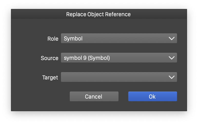

Symbol instances and object references can be searched for and replaced with other symbols using the Replace Objects command from the Styles menu. The Replace Objects command can be used to replace object references with other roles than symbols as well. To replace symbol instances, use the following steps:
- Select the Symbol role in the Role field.
- The list of objects with symbol role are added to the Source and Target fields.
- Select the symbol to be replaced in the Source field.
- Select the new symbol that replaces the previous one in the Target field.
- Confirm the symbol replacement selection, by pressing Ok.
- If objects were selected, the Source symbol will be replaced in the selected objects, with the Target symbol.
- If there were no objects selected, the Source symbol will be replaced in the whole document, with the Target symbol.
The Replace Object Reference view.
