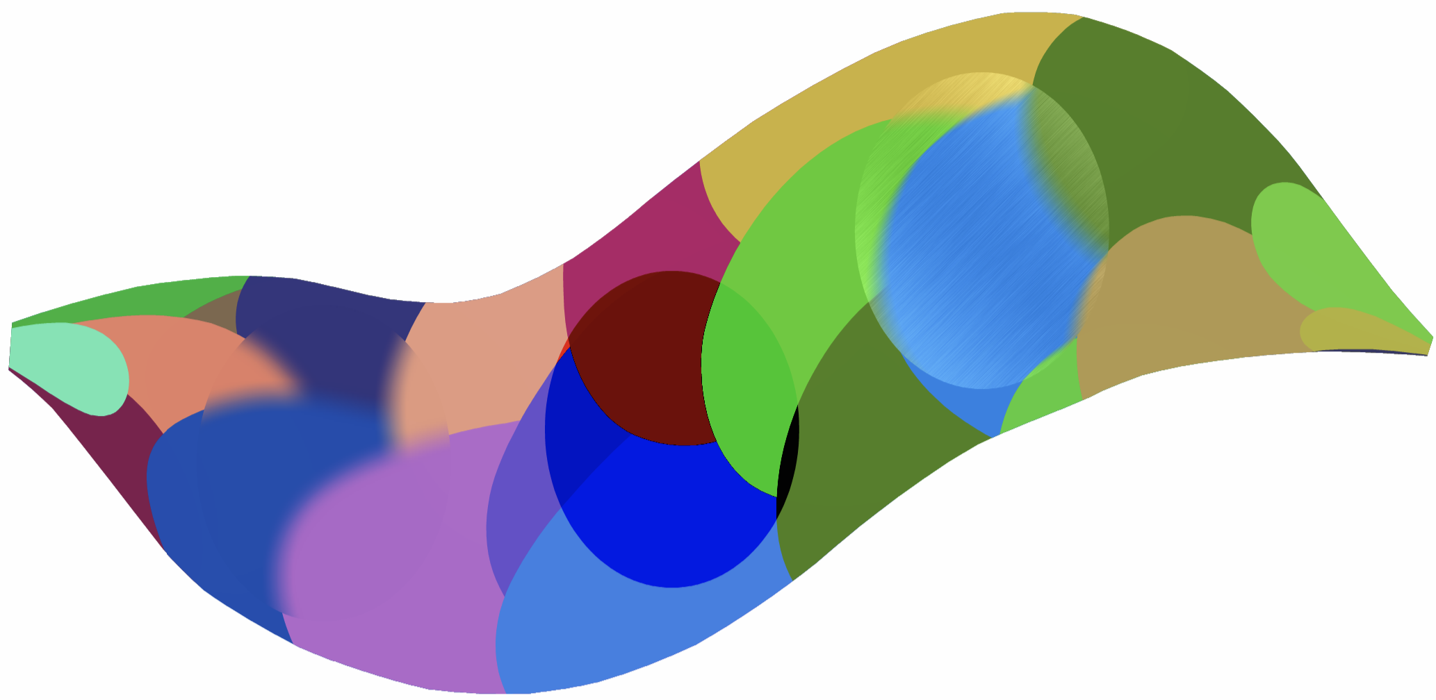

Three adjustment effect objects with elliptic shape: Gaussian blur, color Curves and Add Brush.
