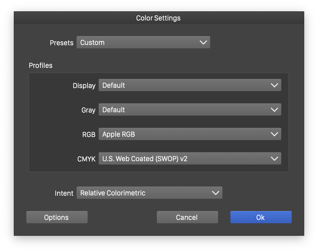

The application level color settings control how colors are displayed on the screen and what are the default conversion schemes between RGB and CMYK color modes. The application color settings can be accessed with the Color Settings command of the Style menu.
Application level color settings.
The following options can be set in the application color settings:
- Presets - Opens a list of color settings presets. The color settings for the display and various color modes can be collected and saved as a single preset. These presets are listed in the Preset field and can be recalled, allowing a quick swapping of the application color settings.
- Display - Opens a list of display color profiles. These are RGB profiles that can be used for display calibration. A display color profile can be edited by selecting the Custom option from the list. The Load and Save options can be used to access existing display color profiles from a file or to create a new display color profile. The display color profile editing is described below.
- Gray - Opens a list of gray color profiles used to describe gray colors stored in the document. Gray color profiles can be edited (selecting Custom), loaded from a file (selecting Load) or saved to a file (selecting Save). The editing of gray color profiles is described below.
- RGB - Opens a list of RGB color profiles used to describe RGB colors stored in the document. RGB color profiles can be edited (selecting Custom), loaded from a file (selecting Load) or saved to a file (selecting Save). The editing of RGB color profiles is described below.
- CMYK - Opens a list of CMYK color profiles used to describe CMYK colors stored in the document and to separate other color modes into CMYK. This field lists the CMYK color profiles available in the system. Use the Load option to load a CMYK color profile from a file.
- Intent - Select the color profile intent.
- Options - Open a menu with a list of additional options used in color settings. These include selecting the color modes visible in the user interface, and selecting the color used to show the gamut warning on display.

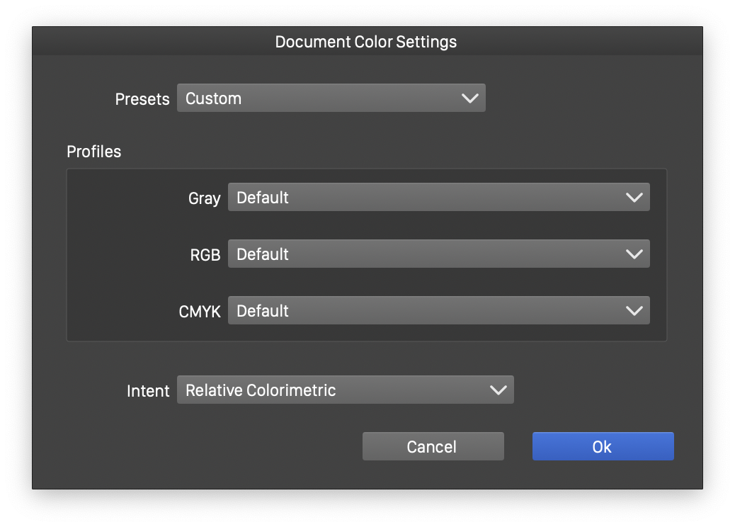

Document level color settings.

Document Color Settings
The color profile settings used to convert color for the display and for printing, and to define the Gray, RGB and CMYK color modes used in the document may be document specific. This requires that the color profiles and associated settings to be stored in a document. To enable color profile embedding into a document, check the Embedded Color Profiles in the Document Setup view Color section. If left unchecked, the color profiles will not be stored with the document
As modern design and illustration is mostly targeted for screen and web, the default sRGB profile is sufficient, and no document specific color profiles are required, embedding color profiles is turned off by default. Embedding color profiles in a document (especially the CMYK profiles), can increase the size of the document files.

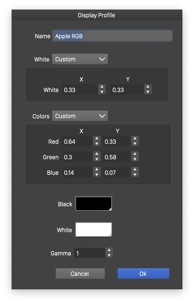

Display color profile options.

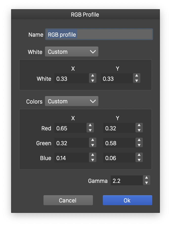

RGB color profile options.

The document color settings can be accessed using the Document Colors command of the Style menu. The document colors view contains the same settings as the application level color settings view, with the exception that there is no Display profile selection and no Option button. The other fields operate the same way as the application level color settings.
Display Color Options
The display color profile options view contains the attributes required to specify the color properties of the monitor used for display.
- Name - Set the name of the display color profile. It is required to set a distinctive name for the color profile, as it will be listed using this name in the color profile list.
- White - Edit the xy chromatic definition of the white tone of the display. Select various predefined white tone definitions from the drop box.
- Colors - Edit the xy chromatic definition Red, Green and Blue colors. The drop box of this area contains a list of predefined RGB chroma definitions.
- Black - Select the color of the black on the monitor.
- White - Select the color of the white on the monitor.
- Gamma - Edit the adjustment of the color tone variations.
The xy chromatic values of the white and the RGB colors, may be obtained from the monitor provider, unless an ICC color profile is provided already.
RGB Color Options
The RGB color profile options view contains the attributes required to specify RGB colors stored in the document. These attributes are similar to the display color attributes, as both are using RGB mode to represent colors. The RGB colors stored in the document are converted to a neutral (internal) color mode using these settings and then converted to display color mode for rendering (or separated to CMYK for printing).
The RGB color profile does not require the Black and White color adjustments.
