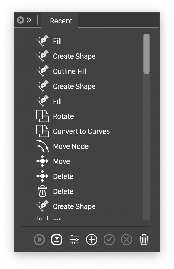

Recent Actions
The Recent Actions panel
Any action, or command making a change on the selected objects, or in the document can be repeated on other selections or documents. A set of most recent commands and actions are recorded and kept in a separate recent actions preset file. This includes changes made from various panels of VectorStyler, commands selected from the menu, or actions played back from the Actions panel.
The most recent change or action can be repeated by pressing the Control+R shortcut. Recent actions can also be repeated, by selecting the action from the Repeat sub-menu of the Edit menu.
The Recent Actions panel contains the list of recent actions, limited to a maximum of 16 most recent changes or actions. This limit can be configured by the user. Double clicking on an action in the Recent Actions panel, repeats the action on the selected objects.
The Recent Actions panel can be used as follows:
- Select one or more actions to playback.
- Click on the
button to repeat the highlighted actions, on the selected objects. - Click on the
button to avoid keeping the selected action types in the recent actions list.
Some actions, like moving an object, may be used frequently, and may clear the recent action list quickly. Skipping these actions when recording the repeatable actions can improve the usability of the recent actions panel.
- Click on the
button to edit the recent action options.
- Spacing - Set the playback delay between two consecutive recent actions, selected for playback in the panel.
- Keep Last - Set the number of most recent actions shown in the panel. Changing this field will clear all recent actions beyond the new limit.
- Save the selected actions as an action preset.
- Clear the recent action skip list. After pressing this button, all action types will be recorded again in the recent actions list.
- Remove the selected recent actions.
- Clear the recent actions list.
Options of the Recent Actions panel.
The typical use of the Recent Actions panel, is to quickly select and repeat one or more of the most recent actions on different object selections.
