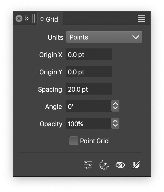

Grid Panel
The Grid panel.
The grid settings of the document, canvas or artboard can be edited using the Grid panel. The Grid panel can be opened from the Panels - Editing menu. The Grid panel contains the grid settings of the document, canvas or artboard. The active grid can be selected in the Select Grid menu of the panel.
The following grid options are available in the Grid panel:
- Units - Select the grid units. The grid spacing is set in these units.
- Origin X and Origin Y - Edit the origin of the grid.
- Spacing - Edit the spacing used in the grid. For different horizontal or vertical spacing, setup multiple grids using the Edit Grid command from the panel menu.
- Angle - Edit the rotation angle of the grid. The angle is used when snapping rotation angles, and determining grid positions.
- Opacity - Edit the opacity used to display the grid. The grid is shown over the current illustration, and the opacity can be used to dim the grid.
- Point - Enable or disable the use of point grids. When enabled, the grid is shown as points, positioned according to the grid settings. When disabled, the grid is shown as lines.
The icon section of the Grid panel contains the following options and commands:
- Open the Grid Editor modal view to edit additional grid options.
- Edit the grid color.
- Show or hide the grid.
- Enable to disable snapping to the grid.

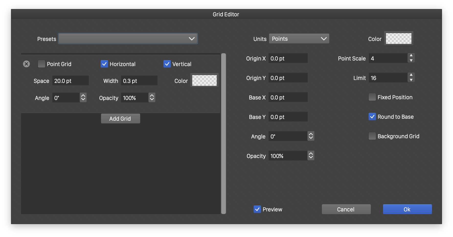

Custom Grids
The Grid Editor view.
The Grid Editor view can be opened using the Edit Grid command from the grid panel menu. The Grid Editor can be used to setup complex custom grid systems, containing multiple grids at different spacing and angles. A grid system can contain an arbitrary number of grid definition, each with its own spacing and rotation angle.
- Presets - Lists the available grid system presets. The current grid system can be saved as a preset, by opening the preset list (clicking on the arrows at the drop box end), and selecting the Save Preset command. The preset is saved with a name, set in the Presets field. Grid system presets can be saved and recalled in different artboards, canvases or documents, to enable the easy reuse of complex grid definitions.
- Add Grid - Add a new grid to the edited grid system.
- The grids of a grid system are listed in the editor view, with each grid shown in a view with the attributes of the grid.
- Units - Select the grid units. The grid spacing and origin is set in these units.
- Base X and Base Y - Edit the base spacing of the grid. The base spacing is used to round all coordinates to multiplies of the grid base, when changing objects.
- Round to Base - Enable or disable the rounding of all coordinates to the grid base, when changing objects.
- Angle - Edit the base rotation angle of the grid system. The base angle is used to rotate all grids in the grid system.
- Opacity - Edit the common opacity of the grid system. The common opacity is combined with individual grid opacities, when rendering the grid.
- Color - Set the grid color.
- Point Scale - Edit the scaling of the point sizes when rendering a point grid. The scaling is applied on the width of the grid items.
- Limit - Edit the smallest spacing in pixels, for showing a grid cell. Grid cells smaller than this limit are not shown.
- Background Grid - Enable or disable the rendering of the grid behind the artwork. By default, this option is disabled, and the grid is rendered on top of the artwork. If enabled, the grid is rendered behind the artwork, and parts of the grid may be obscured by the artwork.
- Preview - Enable or disable the previewing of the current grid settings in the document.
A single grid in the grid system is edited using the view in the grid list. The following options are available.
A single grid in the grid system.
- The upper-left corner of a grid contains the
button used to delete the grid from the grid system.
- Spacing - Edit the spacing used in the grid. Different grids in a grid system can have different spacing.
- Angle - Edit the rotation angle of the grid. The angle is used when snapping rotation angles, and finding grid positions. Different grids in a grid system can have different rotation angles.
- Width - Edit the width of the line used to display the grid. If a point grid is used, the width will be the size of the point.
- Point - Enable or disable the use of point grids. When enabled, the grid is shown as points, positioned according to the grid settings. When disabled, the grid is shown as lines. A grid system can contain both point and line grids.
- Horizontal - Enable or disable the horizontal direction of the grid. The horizontal direction of the grid is drawn along the grid rotation angle.
- Vertical - Enable or disable the vertical direction of the grid. The vertical direction of the grid is drawn at an angle of 90 degree to the grid angle.
- Color - Select the color of this grid type.
