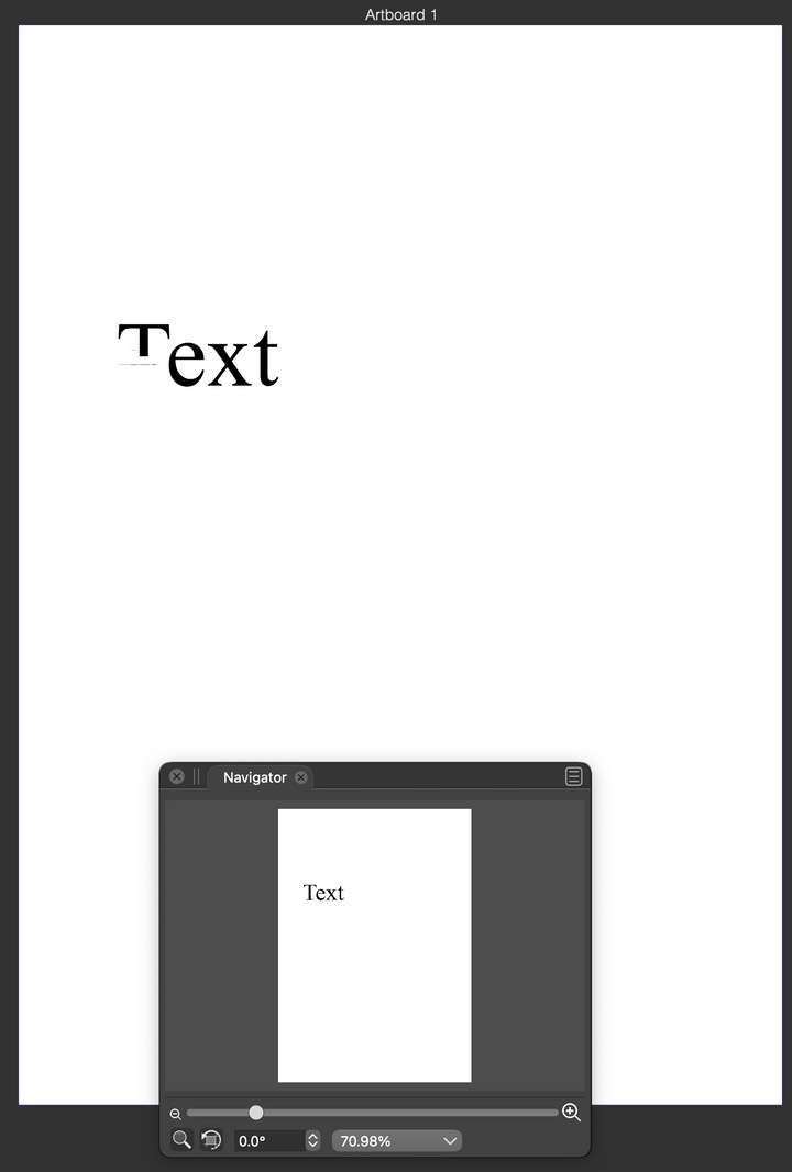

@vectoradmin,
A weird thing happened after I sent it to you.
I never actually closed the document in VectorStyler, I simply opened a new document to work on something else. When I finished it and closed it, the document I sent you was on the screen. Now it was showing a rendering glitch in the text like I reporting in one of my other posts. That glitch was not showing up on my screen when I last left the document to send the file to you.
Interesting also was that the text appears to render just fine in the Navigator Panel, just not on the actual Artboard.
Go figure!
