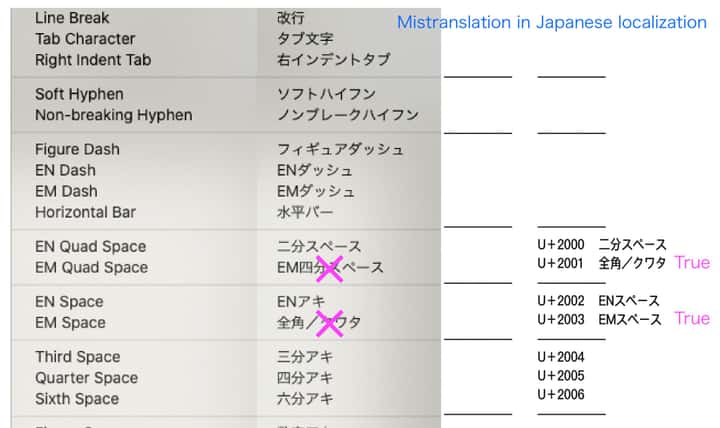

              1. "Quad" Naming and Japanese Localization Fixes
                In my previous message, I shared my guess regarding the "Quad" naming in the menu, but I might have overthought it.
              In the era of Japanese letterpress printing, a "Quad" was pronounced as "KUWATA". It referred to a spacing material used to fill gaps, which essentially meant a "ZENKAKU (full-width) space". However, this term is rarely used in modern Japanese printing environments today.
              Given this background, I would like to propose the following corrections for the Japanese localization of the menu. Please also refer to the attached visual reference image
              (menue.jpg).
              • (U+2000): "二分スペース"
              • (U+2001): "全角/クワタ"
              Letterpress experts might have different opinions, but considering its practicality as a modern DTP tool, I believe the names proposed above (and shown in the image) are the most intuitive and optimal for current users.

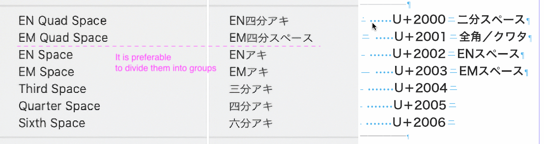

              1. Suggestion for Menu Grouping
                Regarding the menu structure, I recommend inserting a separator line to group the items inherited from the letterpress era (such as U+2001) separately from the items of the digital era (such as U+2002). (Please refer to the suggested layout on the right side of menue.jpg). This visual separation will make the menu much easier for users to understand.
