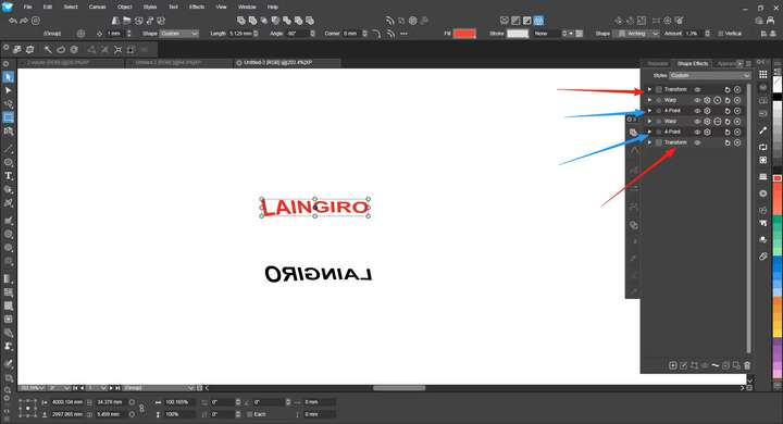

In the operation process, I mostly use shortcut keys for most functions. When I open the Effects panel, I notice several duplicate effects, specifically the 4-point effect and the Transform effect. I'm not sure if this is by design, but at least the Transform effects should be mergeable.I had already applied the 4-point effect and added some other effects afterward. When I tried to continue using the 4-point effect via the shortcut key, it created a new instance instead of continuing the operation on the existing one, resulting in several duplicate effects. Is it possible to merge them?
