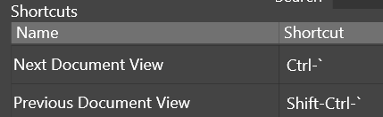

 Navigator View Presets are not working as expected, at least when it is set to the Document: -Reloading a View sometimes takes me out of zone completely someplace outside of the document. -The shortcut, or at least I suspect it is the shortcut, for Switch Document View doesn't appear to work. Or at least I can't tell what that specific set of shortcuts is meant to do. This one is the one I am trying in video (you can see keyboard feedback in the bottom left as I hit keys...):  -When removing a Preset, it stays up as the currently selected View. -Note when adding "Test 4", "Test 3" starts working correctly. Then Test 3 stops working, Test 4 works. Very odd. -I just tested normal View Presets and it also has the same problems as above. *If my typing seems off, I'm attempting to use a keyboard across a dog and a large Wacom. So there's that. Video: https://1drv.ms/v/s!AuWHX0h5bAoRipMcm5_A-DEv8gVkYg?e=B7EmAO

 @debraspicher said in Navigator View Presets are not working as expected: The shortcut, or at least I suspect it is the shortcut, for Switch Document View doesn't appear to work The shortcut is to switch between different views created with the View -> New View command.
