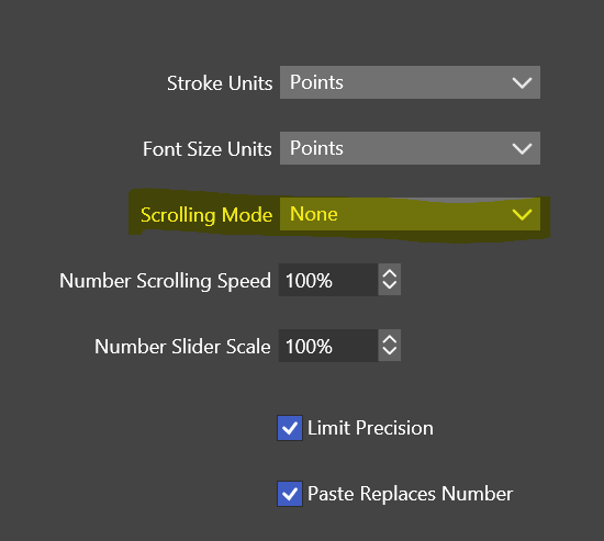

I had to turn off Settings>Number Editors>"Scrolling Mode" because other fields seemed to be misbehave more with it enabled. I seem to remember it would also behave similarly where it seemed to treat dragging as scrolling behavior.

Question: Is it supposed to drag to modify the field? Is the "Scrolling Mode" related? I have this set to off. I don't see a drag setting here:
It does seem much easier to drag backwards than forward at various points. Can't see the reason for it.

@debraspicher The "Scrolling Mode" settings determines how to handle swipes (scroll wheel) when hovering over a text field.
