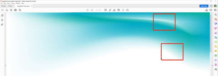

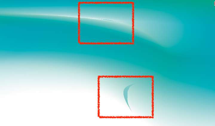

Mesh gradient: Artefacts appear when exporting to pdf
Artefacts appear when vs exporting to pdf. These happens with the default settings and looks buggy
Perhaps I have missed a specific export setting to use when image is containing a mesh-gradient?

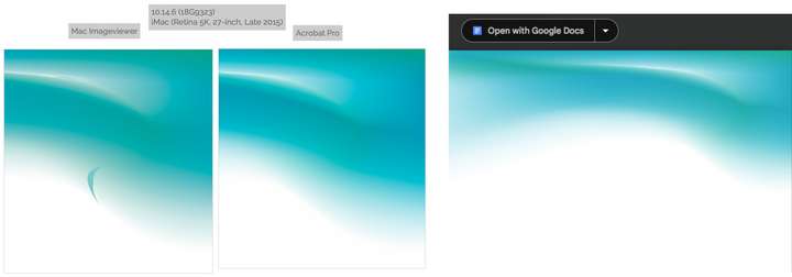

The artefacts is not persistent, but appears under circumstances on my system.Opened in:
Mac Viewer/artefacts – YES
Acrobat Pro/artefacts – NO (artefacts stil present in MacView efter Acrobat save)
Indesign, placed graphic/exported/artefacts -- YES
Illustrator, opened as pdf/artefacts – NO (re-exported as pdf – YES)
Printed by Brother HL3140CW – YESIll make a test on another workstation next week and notice you.

Just for the record: I notice the issue has been discussed further but just add this from another, newer MacOS workstation as promised earlier.
Conclusion: The VS outputted pdf's with mesh grad. appear with artefacts on Mac Imageviewers and on printers only.
