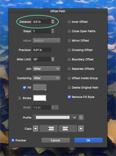

Bug: Offset Amount resets if initially set with slider then edited manually and tabbed away from
I noticed with the Offset Path Panel, if I adjust the distance with the slider and then edit it further manually and then tab away to go to the next box, the distance resets to 0.00.
Here is a video of me testing this along with other combinations of actions
@Boldline It is a bug and can be replicated here also. As a workaround, remove the "in" part at the end when editing the number.
