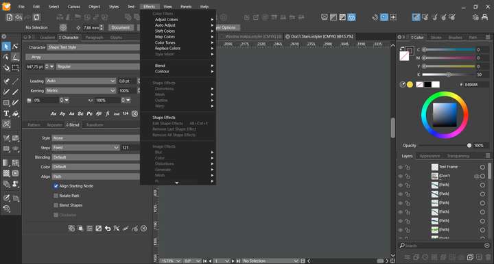

In my opinion, we have another issue here.
For some menus, is there a need for this knob to scroll the menu down at all?
On my 125% scaled screen, I have plenty of room to expand most of the full menus. It is also visible on the @Subpath video that this little knob only expands a few lines of the menu that would fit the screen anyway.In other words,some menus are shortened by the downward triangle too early:
