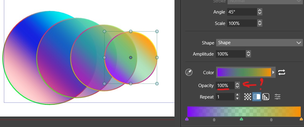

The opacity value stay at 100%
  • I decreased the opacity value & the opacity decreased but the value stays at 100%:

  • @b77 that's the Gradient panel ☺
    @Pat Does it show the opacity if you select a gradient knob (on the bottom of the panel)?
    That opacity value should be associated with gradient stops.
  • @VectorStyler yes indeed, and only the centre knob has reduced opacity. However, I have selected the whole object, so shouldn't all the opacities of the different knobs be modified?

    @Pat said in The opacity value stay at 100%:
    Even if the whole object is selected, it contains different opacities at different locations, and those are shown / edited only if that knob is selected.
