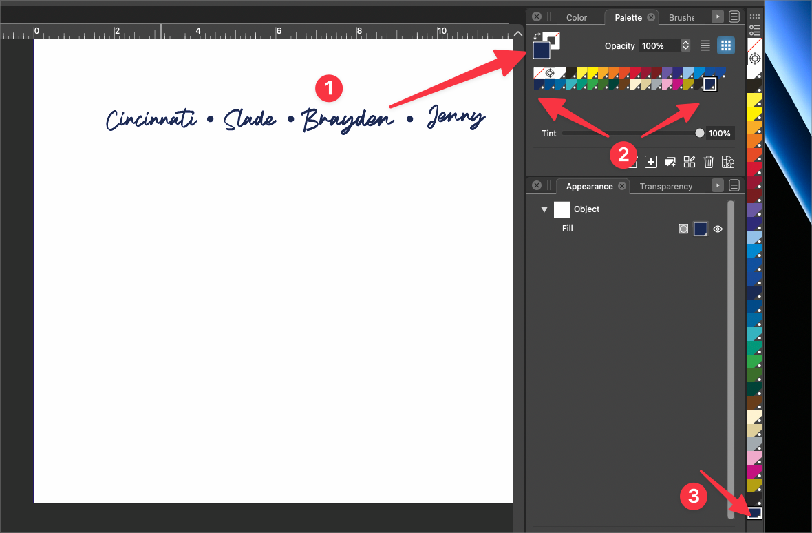

I'm using build 91 but still running into a duplication problem when pasting something that has a spot color into a new file that has the same custom palette where that spot color already exists.
So in this case, referencing the image pasted below in this post, I pasted text into a new file that was previously created in another file using a spot color that is shared in both custom palettes. The text I pasted was pantone 2767. (#1) After pasting, it made a new spot color of the same name (pantone 2767) as if it were a different color. I have arrows pointed at the old and new "pantone 2767" (#2) The only import setting I have for the palette is "register by similarity" . I also noticed the palette bar recognizes the same color in it's palette set (it's the same palette file as the one used in the palette panel) (#3)
This same thing has happened in other files in build 91 where I've pasted from other sources.

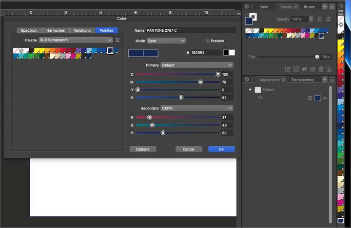

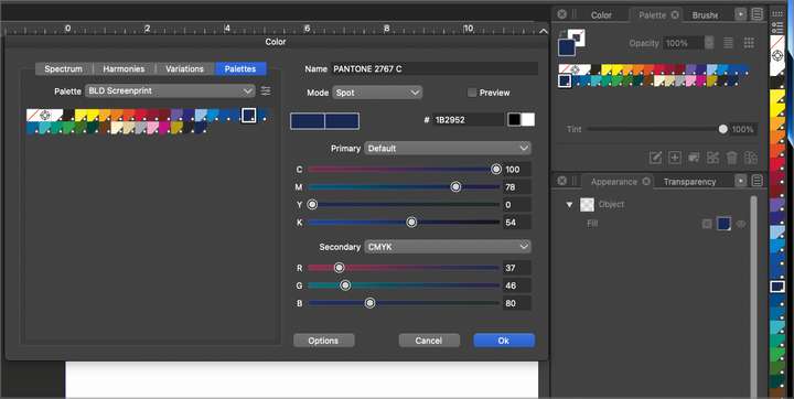

They are both labeled the same name and their information seems to be the same in both color info panels when double clicked upon. I attached both images to this post.
Also, I had uploaded the file to the first post in this thread if you wanted to open it and check anything
