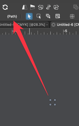

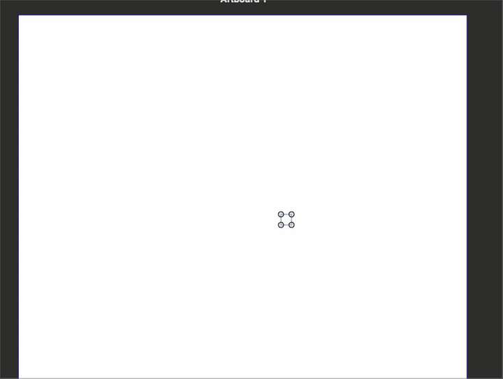

@b77 I tried restarting VS, refreshing VS and then also restarting the entire computer and nothing has worked. I reset the workspace back to default and it still did not work, but when I deleted the strange rectangle invisible shape, I was able to use the pen tool again
@Boldline It's Bermuda's T̶r̶i̶a̶n̶g̶l̶e̶ Square.
@b77 it was totally odd and crazy, that’s for sure!
@Boldline The small (single) nodes cannot be scaled (there is no size).
And if they are selected, it seems that the Pen tool indeed is not working.
Try without having them selected, or remove these small nodes from the Layers panel.

My pen tool stopped also with the same a small invisible rectangle.

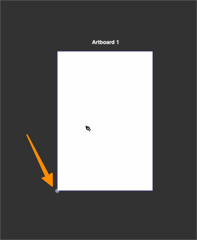

Sometimes I can use the pencil tool to start a stroke and then switch to the pen tool to continue it.Sometimes as I am using the pen tool, I'm getting a small indicator circle at the bottom left corner of the artboard that goes away.

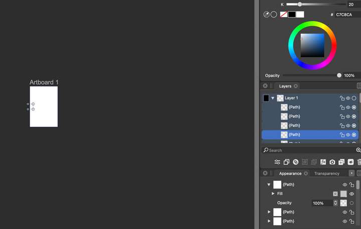

Using the file I sent, I was noticing the invisible boxes show up in the layers panel.
I can select them using the layers panel and some of them, I can scale.
