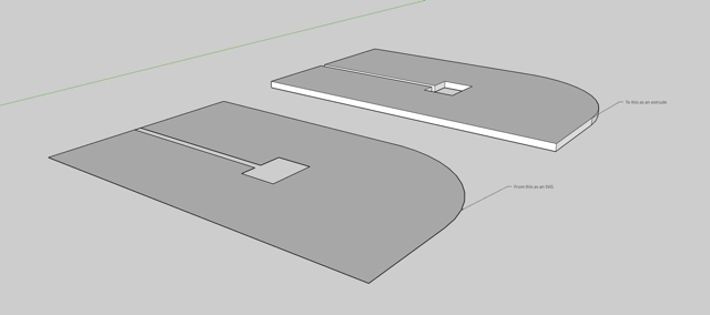

              • IgullI Offline
                Igull @Subpath
                @Subpath said in 3D Help:
                could you post some pics of the Results you like to have ?
                Essentially, they are all a simple flat plate extrude from an object. They don't need shading or shadow.
                Neil
