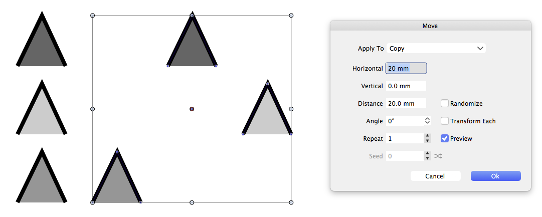

There may be a bug using the Transform >> Move modal when more than one object is selected.
In the pic below, the three triangles at left have been selected, and the Move modal used to move horizontally (by 20mm).
As seen, the upper triangle has instead moved by 40mm, the middle triangle by 60mm and the lower triangle by the intended 20mm.
The expected behaviour is that they should each move by the same amount.Same with Vertical moves and Distance/Angle moves.
Same with moves in the full Transform >> Transform modal.
Problem survives resetting Workspace and Settings.No problem if moved one at a time.
Also no problem if the objects are first grouped.
Other types of transform (scale/rotate/skew/reflect) seem ok.
@Raven Can be replicated. Looks like a regression, that was there for some time.
Will be fixed ASAP.
@Raven This issue should be fixed in build 1.1.080
