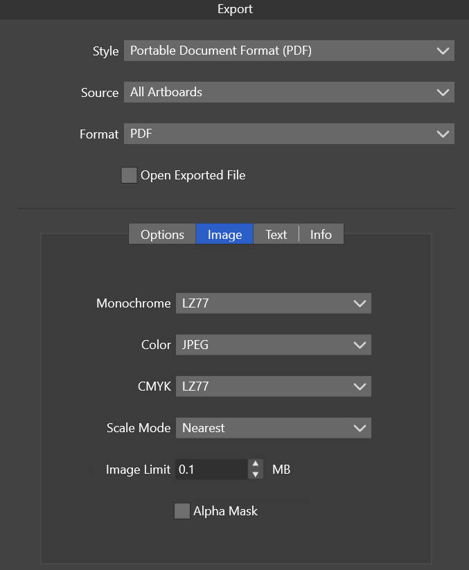

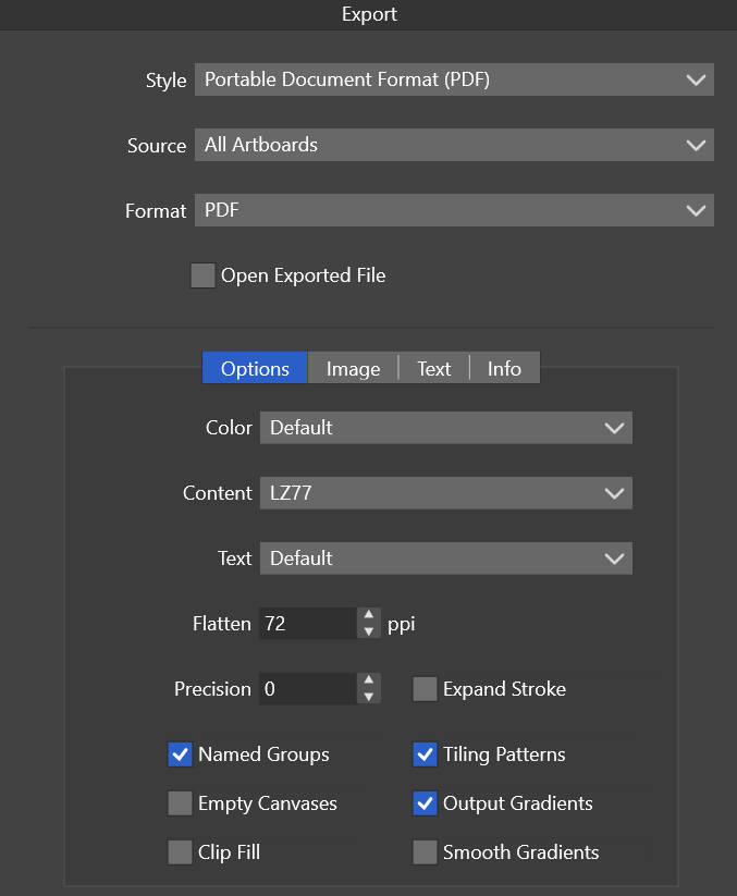

Use the following PDF export settings:
- Open the generated PDF file.
There is no image in the PDF. Do I need to set something to make them appear in the PDF?
@gotanidea Replicated, will try to fix it ASAP.
@gotanidea The Precision field (first export view - PDF Options) should be larger than 0, more like 2.
(should not allow 0 here, will fix this).
@VectorStyler said in Image Not Shown in PDF:
(should not allow 0 here, will fix this).I see. Thanks Admin
