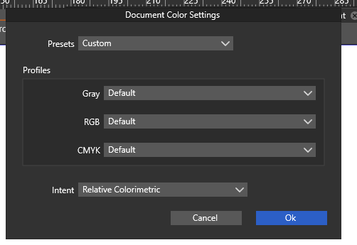

@b77 Yes, before I wrote the post I tried to solve it myself. I set the Default RGB.

In the Styles -> Color Settings (and Document Colors), there are some global / document color profile choices.
What is selected here.Also: on Windows, by default the document display may use some color profile.

Changing profiles does not trigger any change.
In addition, I had the problem to restore the default settings. They would not save. I tried several times.
