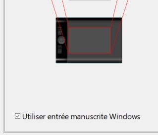

I just deselected Windows Ink for VS. I'll test further whether there is a connection between the two (WI/VS) and VS bugs.

Nothing with the Intuos4: I've looked in the settings & I don't see what could be the issue. But when I've activated the inking stuff, I could only draw lines (pen tool) and not curves and I'm sure not to have press any keyboard (far from my hands ;-). I deactivated WI and I could draw curves with the pen tool again.
