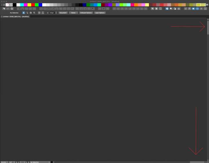

Sudden scroll jump of the document to its extremes
This has happened three four times now.
I think when the application has been unused for a while
Suddenly everything turns dark gray and the arboard is gone.
First it was a graphical render error
...but after a while i realized that the scroll bars had jumped to top and far right
not sure why and how to reproduce.
but here is a screenshot
@ncic said in Sudden scroll jump of the document to its extremes:
Does that mean that pressing Cmd-0 doesn't zoom to the artboard?
@ncic Was there any isolation mode editing of groups? or artboard creation undo / redo?
i just tried to replicate after being in idle mode. luckily i read this thread just before.
so i went into vstyler that was open in the background since yesterday
double clicked an object (not grouped) to get into isolation mode
and it happened yes, it shoot the scrollbars to the extremes and the dark gray outskirts of the document fills the screen.tried the cmd 0 shortcut and it zoomed out and centered the entire artboard as expected
and doubleclicking the same object now after this works as normal. no scrollbar extremes.so yes
it seems to be connected to going into isolation mode and the program being unused for a while.
thats the only two factors i can think of for now

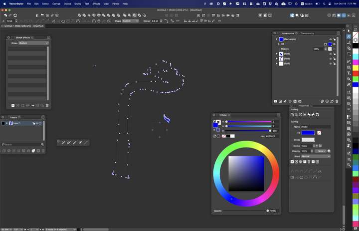

when i pressed down the cmd key to take a screenshot, even if the document was at its extremes i saw the entire armature of the vector shape appear with its anchor points and all, here in the outskirts of the document
even if the actual shape was in an artboard somewhere else in the middle of the doc.
but its the same position in relation to the screen boundries as it had been prior to the jump.
so some type of ghost of the vector path but responsive to the cmd key pressi took a screenshot

I open an other bug on this, and will try to replicate it.EDIT: from the screenshot, it looks like the fills were not displayed. Is that also the problem?
at the moment so far not seen any problems with the fillsthis display of the curve was the special edge case (pun intended) when the document reached its extremes
nothing was visible except the gray background
until i pressed the cmd key down this path appeared while i was holding the cmd key downtook my screenshot
then i pressed cmd zero and got back to the center of my document my shapes were displayed normally with fillsand correct
