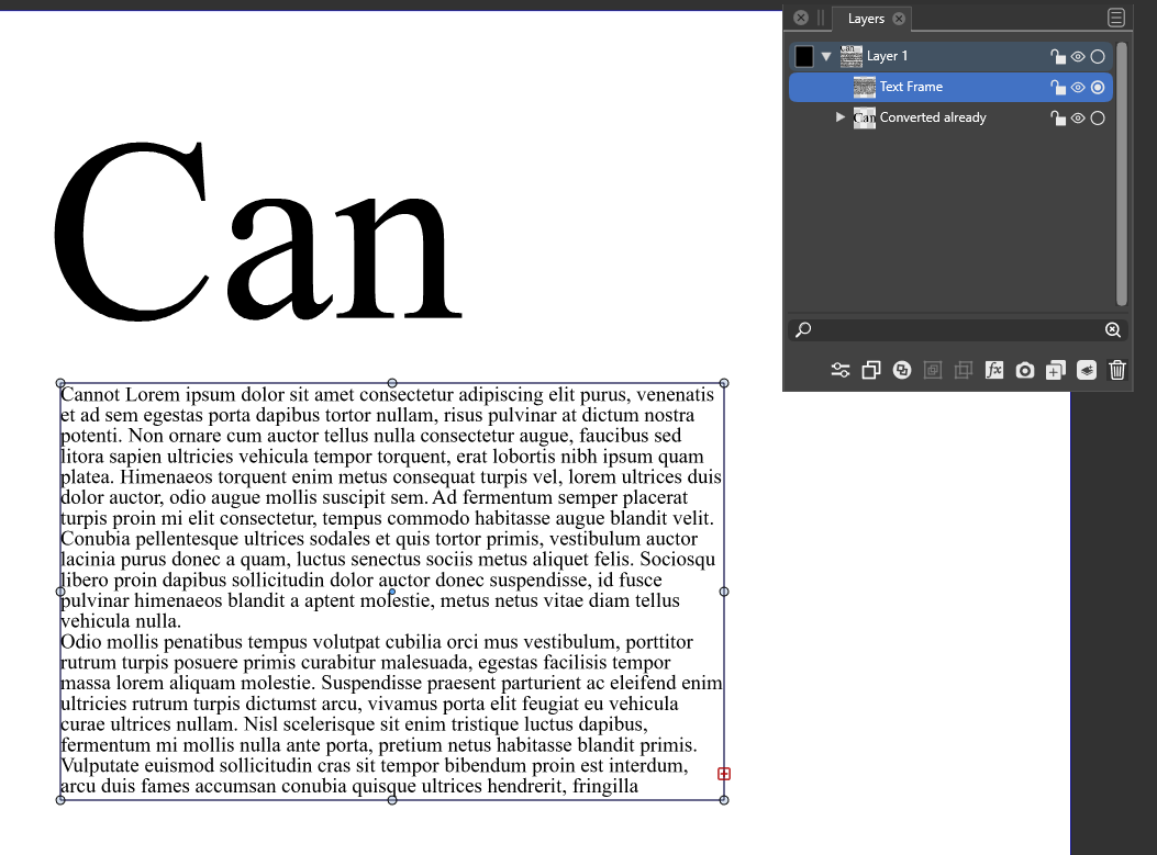

    I cannot convert a text frame to curves
    12 Posts 6 Posters 11.3k Views 4 Watching
    • IngolfI Offline
      Ingolf @Devil Dinosaur
      @Devil-Dinosaur said in I cannot convert a text frame to curves:
      Try : text-> "Convert to Shape Text" first, before converting into curves
      Thanks. And then I can convert it to curves.
      But I guess it is a bug, @VectorStyler? I should be able to convert it to curves in one go via object->convert to curves?
      ๐Ÿ macOS Sequoia Apple Silicon
      VectorStylerV W 2 Replies Last reply Reply Quote 0
        VectorStyler @Ingolf
        @Ingolf said in I cannot convert a text frame to curves:
        It is not a bug. When a text frame is selected, the convert to curves will act on the "frame" shape.

        • W Online
          William Kansepa @Ingolf
          I will agree with @Ingolf here... This issue becomes a nightmare if you have a text frame with more than one column or row and the suggested method of Convert to Shape Text will not work. The layout of the text frame is altered.
          As already suggested by @Ingolf, wouldn't it be better if one could just click on the Convert to Curves command to efficiently and accurately get the job done?
          HPโ€ขWindows 11 Proโ€ข11th Gen Intel(R) Core(TM) i7-1165G7 @ 2.80GHz 2.70 GHzโ€ข RAM: 16.0 GB (DDR4)
            VectorStyler @William Kansepa
            @William-Kansepa said in I cannot convert a text frame to curves:
            Since the Convert to Curves in this case works on the text frame, what about having a separate action (menu item) for converting the content of a text frame to curves?

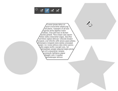

                    @VectorStyler said in I cannot convert a text frame to curves:
                    BTW: it is possible to copy/paste any parametric shape (ellipse, polygon, star) onto a text frame as the shape of the frame and then edit the shape parameters.
                    @VectorStyler Would you be able to elaborate on this some? I was looking in the documentation for the steps to replace a text frame with a parametric shape but nothing I tried seemed to work. Most likely user error on my part.
                    But this ability sounds awesome and I'd like to do it
                    ๐ŸŽ macOS Tahoe 26.2, Mac mini (M1, 2020), Chip Apple M1, Memory 16 GB
                    VectorStylerV S 2 Replies Last reply Reply Quote 0
                      @Boldline Select a shape and Edit -> Attributes -> Copy Shape. Then select the text frame and Edit -> Attributes -> Paste Shape.
                        Subpath @Boldline
                        @Boldline
                        As an alternative, you could also use the Shape Picker tool, I guess.
