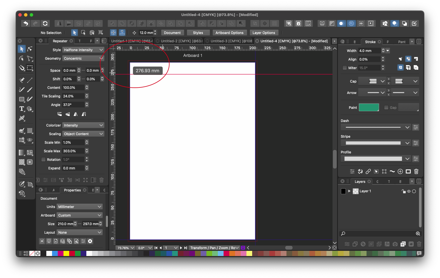

        @Ingolf Option-dragging from the ruler's origin moves them where you want (at the top-left corner, for instance) but it doesn't also switch from cartesian to top-down as it seems to be doing in CDR.

              b77 @Ingolf
              If I understand correctly, web designers do prefer the top-down coordinates format (because resizing an artboard doesn't take/"glue" the objects to the top along with it), more technical (think 2D CAD) designers prefer the cartesian format for obvious reasons, and those who do freehand drawing don't care and won't complain.
              I'm curious, is the ruler origin snapping to the corner of the page or not in CDR?
              I hope it does (not that clumsy then), without having to enable their version of 'Snap to Artboards'.
              IngolfI 2 Replies Last reply Reply Quote 0

                            @Ingolf This should be possible in VS by Option+Press and drag from the ruler corner. But it will not change the direction, only the location of the origin.
                            b77B IngolfI 2 Replies Last reply Reply Quote 0
                              b77 @VectorStyler
                              @VectorStyler said in Weird rulers:
                              I think it should change the direction — anybody who moves the ruler origin to the top left corner needs top-down coordinates.
                              And snap to the artboard corner. 🙂
                              Other than that, I just downloaded the trial of CDR 2021 (a major vector graphics app, no doubt) and cartesian coordinates are the default. (Which I don't mind at all, btw).
                              But as can be seen in @Ingolf's quick video, when you drag the ruler origin to the top left, it switches nicely to top-down coordinates.
