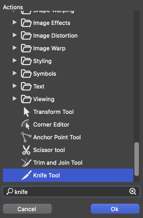

I need to assign 'C' to the corner editor (from the toolbar), but I can't find it in the shortcut editor. I search for 'corner' but get a result that is not what I want. I can't select 'Next' or 'Previous' in the search results, so I'm pretty much stuck. It also applies in preferences that you can't search further or back for that matter.
If you press ENTER in the search box out of habit, the dialog closes. Then, if a little nervous after this experience, you happen to press the icon on the right side of the input field thinking it means start search, the search string clears. The icon with a magnifying glass and a tiny x inside is misleading, mixed and non-standard, an X alone please.
I click and look for the corner editor, but it's impossible to find. I look in the toolbar and see that knife tool is in the same group as corner editor, and search for knife. Then I find corner EDITOR, which is one of the last items in the list of tools, and therefore will always be difficult to search for when there are tools with identical names.
Finally I succeed, C for corner editor, aaaah.
