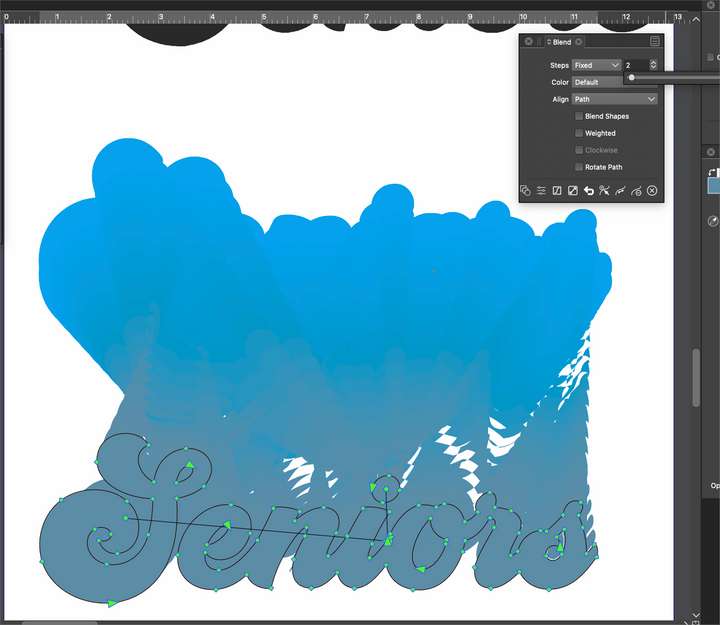

  • I don't know if this is a bug or a user error on my part. I am trying to make a simple 2 step blend between the light blue top object and the darker blue "seniors" I did not have the lower one (seniors) "combined". It's giving me a crazy blend pattern that does not make sense to me. Here is the video
    If I remember correctly, making several objects to be blended "combined" as one object in the blend process is now possible but not required.
    interestingly, when I made the word "seniors" a combined shape, the blend in the picture disappeared entirely.
    I'm wondering if this is a regression, because I've made blends in the past without issue.
    0_1647388073245_bb78dbd2-961d-4a1b-9ed0-0fc5d9243bed-BLD 2022-03-15 at 19.47.44.png

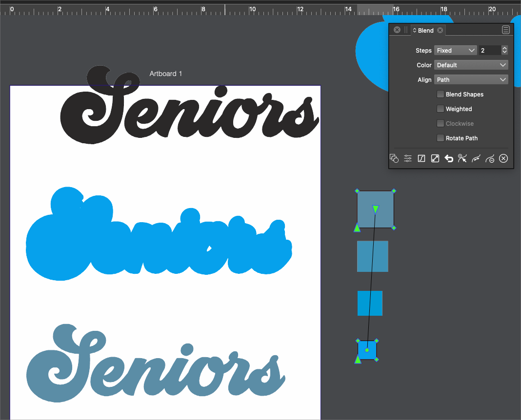

    Interestingly, when I made two simple squares, it did exactly what it was supposed to - so it seems my issue is with the letter shapes?
    0_1647388549901_43e9af72-7f14-4de9-a4f4-be43749546b2-BLD 2022-03-15 at 19.54.53.png
  • sent you a couple files @vectoradmin
    @Boldline Yes, the problem can be replicate here too. It is an error in how one shape is mapped to the other, added it to the backlog.
