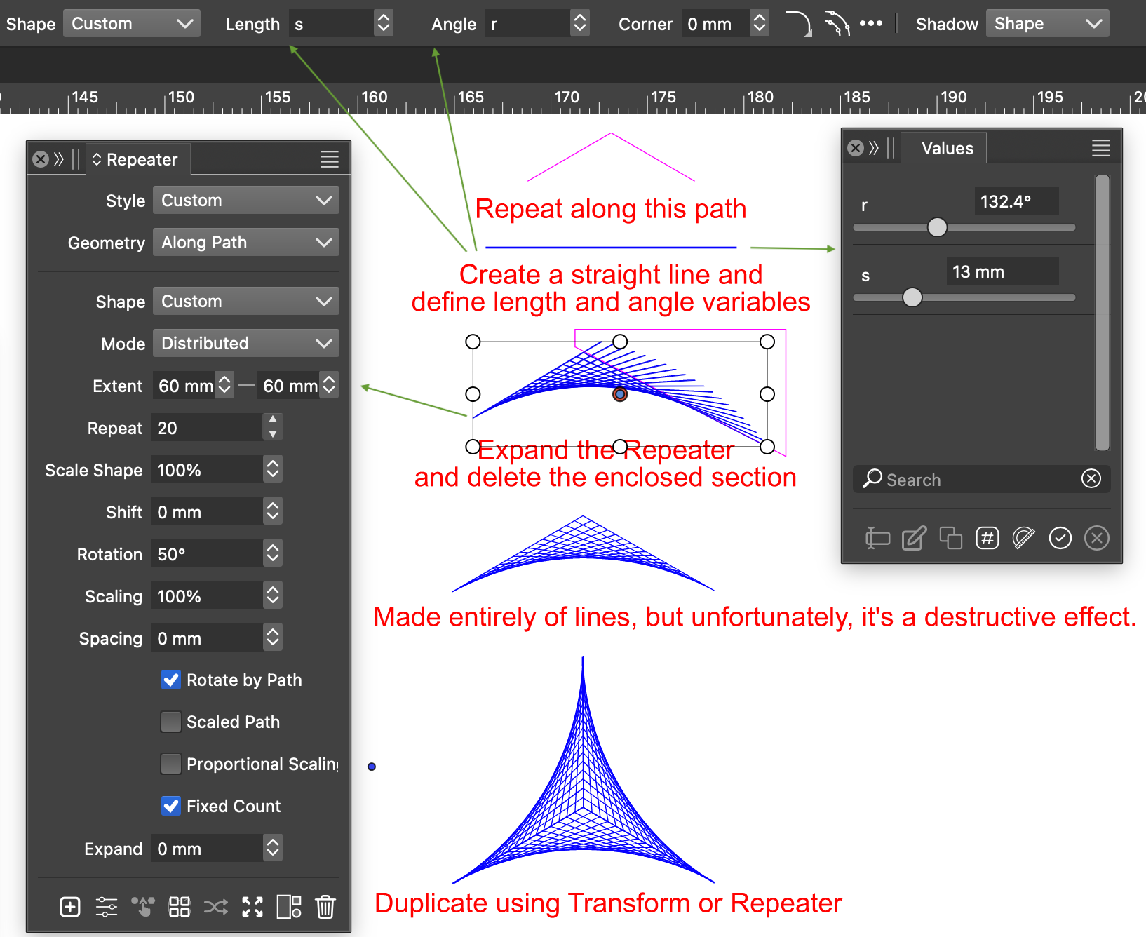

                        • L Online
                          Li Xiao @Subpath
                          @Subpath Node-based apps can indeed create some very unique patterns through different node combinations, but combining different tools in VectorStyler is also super versatile! It is possible to build this with lines using the Transform tool or the Repeater, but the drawback is that it cannot remain non-destructive. As a result, making tweaks and adjustments isn't quite as convenient as in node-based workflows. Attached is a screenshot demonstrating the Repeater approach.
