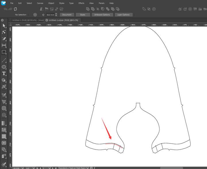

  • 0_1713623850462_mmexport1713623683169.png 0_1713624002712_Untitled-1.vstyler 1、After the black line path is offset, only a section of the red that appears is red, and it took a long time to find the reason before realizing that the red path is inside the mask of the black path. I hope to fix this bug. I tried to create a new file, paste this graphic, and there was no such problem again.2、At the same time, selecting three paths for offset will disappear. Attached file, please check the reason.
    @monsterfox Somehow, the red line ended up inside the black line, in which case the black line will form a clipping path over the red line.
    Since the black line is open, the clipping path will be a closed version of it (by connecting the two ends with a lines, you can see this by filling it with a color).
    This will clip the red line around halfway.
    So just ungroup the whole thing and the full red line will be visible.
    Also: I noticed that these paths contain lots of nodes. You can use the Object -> Simplify Path tool to reduce the number of nodes, by first converting them to curves (most of these are lines).
