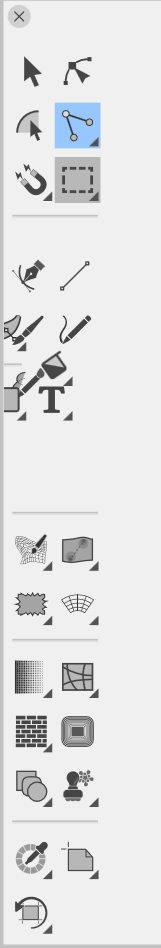

    1. Panels > Toolbox Style > Chose "Two Column Toolbox".
    2. View > Customize > Customize Toolboxes
    3. Add Group under "Drawing" with a label "Pen, Brush" and added the pen and brush tools to it.
    4. Clicked OK.
    5. Result:

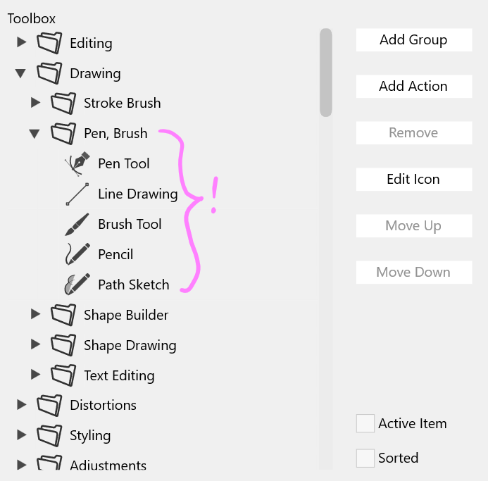

    Here is the Toolbox Group Setup:
    I can include the "*.vswork" file if need be, but the bug should replicate with these instructions.

    I think it is caused by the odd number of folders in the Drawing group.
  • @VectorStyler I tried adding another subgroup to the drawing group to make it an even 6 groups and it did not solve the issue. It appears that the Pen Tool, Line Drawing, Brush Tool, Pencil, and Path Sketch tool are not in a subgroup in the toolbox interface.
