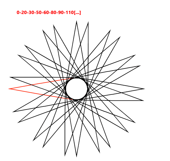

Alt+ Scroll wheel creates new obcjects while changing width/height value in Transform Panel
I was wondering if Alt has an assigned function when changing the width and height values of an object. Turning the scroll wheel when Alt is pressed creates new copies of the objects.

@encart Yes, conflicting modifier key problem again.
Holding Alt while confirming a value in the Transform panel will duplicate the object. This is by design.
I will try to find a solution for the scrolling conflict.

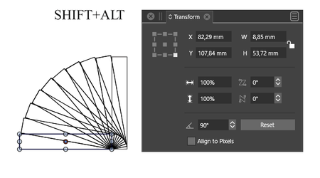

Here a video(creating shape copies with holding Shift+Alt (win) while
changing the Value with the Scrollwheel in Rotation Field)
(instead of Scrollwheel, works with the Arrow-keys too)

Found out that using the Alt-key to copy
shapes in the Transform panel (Panels > Transform)
does not work consistently.It only works with scaling and rotation.
Move does not work.So in this state it is yet more like bug
then a feature.
