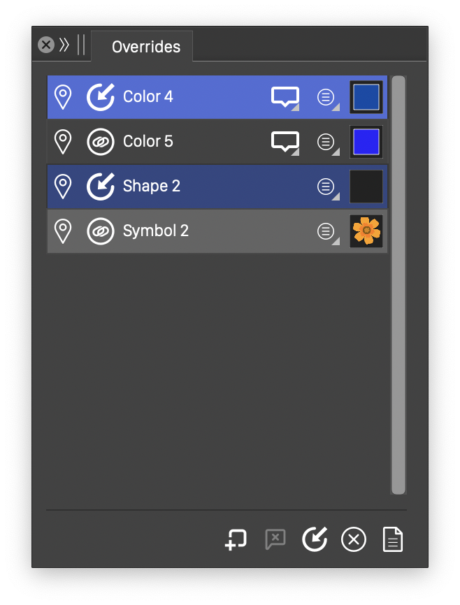

The style overrides can be managed using the Overrides panel. The Overrides panel can be opened from the Window - Styles menu.
The Overrides panel contains the list of styles used in the selected objects. If no objects are selected, the list of styles used inside the current canvas are shown. To show and manage styles of a layer, select the layer using the button.
The styles listed in the Overrides panel can be modified using the preview icon at the end of the row containing the style (for example, the icon). Clicking on the preview icon opens a modal editor view, specific to the type of the style. Some styles cannot be edited in modal editors. For these styles, the overrides can be selected by selecting an other style or preset from the list opened with the button. For example, symbols can be edited only on a canvas, and there is no modal editor for symbols. To override a symbol, select an other symbol using the button.
The styles with overrides are shown with a different background in the list. The following override indication is used:
  • is a color style, that has no override and it is not selected.
  • is a stroke style, that is selected but has no override.
  • is a symbol, that has an override, but it is not selected.
  • is a color style, that is both selected and has an override.
The style overrides can be managed using the buttons in the override panel:
  • - Creates new symbol parameters from the selected styles.
  • - Remove the symbol parameters associated with the selected styles.
  • - Create a style override for all selected styles. These overrides will be the same as the original attributes. Since these styles have overrides, changing the document level style, will keep the override attributes of these styles. When creating style overrides, the style definitions are copied to the object, layer or canvas.
  • - Clear the override for all selected styles. The style will revert to the attributes used in the document level style definition. When clearing style overrides, the style definitions are removed from the object, layer or canvas.
  • - Select between showing the styles used in the document, or on the current canvas / selection.
  • - Indicates that the style has an override. Clicking on this icon will clear the style override.
  • - Indicates that the style has no override. Clicking on this icon will create a style override, using the current style attributes.
  • - Open a pop-up editor for color, gradient, pattern and noise fill styles, to edit the style override. This is an additional tool for editing the style attributes.
  • - Creates a symbol parameter from the style.
  • - Removes the symbol parameter associated with the style.

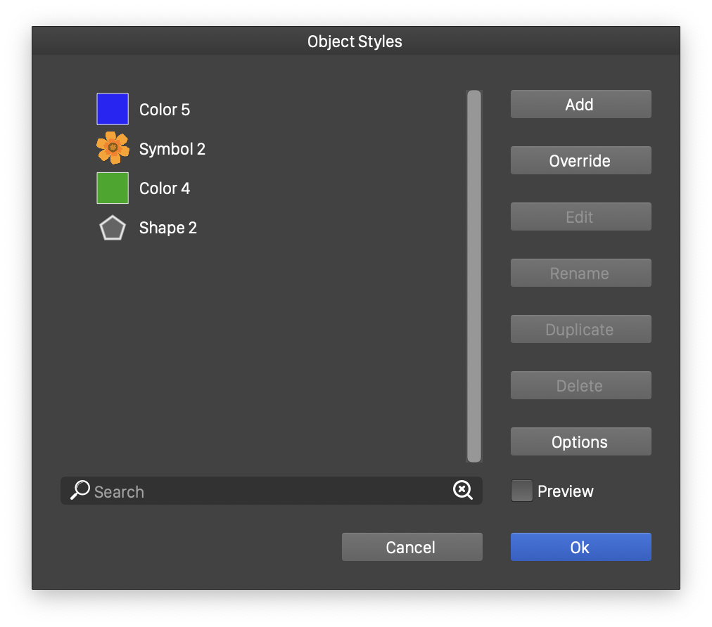

The selected object (including layer) style overrides can also be managed using the Object Styles command from the Styles menu. This opens the Object Styles view, containing the style definitions inside an object.
The style definitions and overrides of the current canvas, can be managed using the Canvas Styles command from the Styles menu. This opens the Canvas Styles view, containing the style definitions inside the current canvas.
The style editor view, lists only the styles defined in the object or canvas. These may be style overrides, or may be new style definitions available only inside the object or canvas. The Styles panel can be used to show the styles of a canvas or the selected object, by selecting the Canvas Styles or Object Styles options from the panel menu.
The style editor view for object or canvas styles, works in the same way as the Document Styles editing, described in the Styles section. The only difference is the place of storing the styles (object or canvas, instead of document), and the mode of adding a new style.
When editing object or canvas styles, a new style can be added by pressing the Add button. This opens a list of styles available at the document level. Selecting a style from this list will add a style override to the object or canvas. To add an independent local style, select the New Style option from the list.
