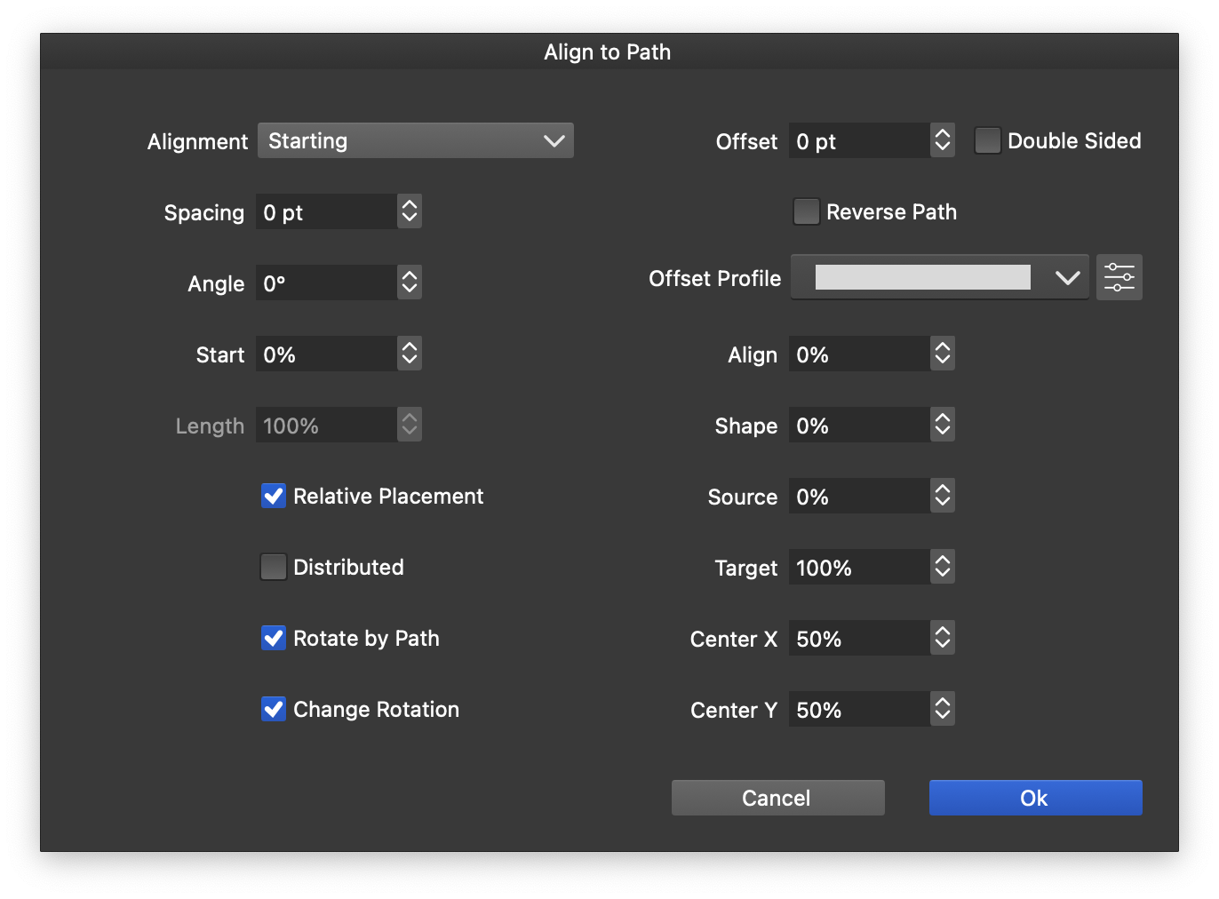

Align to Path group options.
The following options are available:
  • Alignment - Align the objects to the Starting, Center, or Ending position of the path.
  • Spacing - Set the spacing between objects.
  • Angle - Set the objects’ rotation angle.
  • Start - Set where the arrangement starts on the path.
  • Length - Set the length of the path section used for the arrangement.
  • Relative Placement - Express Start and Length relative to the path length. When disabled, these fields use absolute values.
  • Distributed - Distribute objects along the selected length of the path.
  • Change Rotation - Adjust the objects’ existing rotation. When disabled, rotation along the path is added to each object’s existing rotation.
  • Offset - Set the distance between the alignment axis and the path.
  • Reverse Path - Reverse the alignment direction.
  • Profile - Choose a profile for the alignment axis offset.
  • Align - Set the reference position relative to the alignment group’s width.
  • Shape - Set the reference position along the alignment path.
  • Source - Set the reference position on the aligned object.
  • Target - Set the reference position on the previous object in the arrangement.
  • Center X/Y - Set the reference center of the aligned objects.
