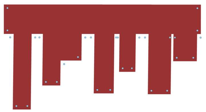

      Many problems are behind us, but I have been experiencing this for as long as I can remember. Occasionally the rounding handles are missing. Surprisingly, this happens even with right angles. In the case of obtuse angles, the rounding can act up to a certain point, and after it is exceeded, it returns to the original point.
      Does the problem also affect others?
      https://recordit.co/wwweFsc2QU
      https://recordit.co/xVrrj6wbY7
        @encart Could not replicate this one (tried to draw a similar shape). Can you send me the file by email, with the shape where this occurs? Thanks!

          @vectoradmin I just sent it.
          I tried to add it here but shows popup about missing permission

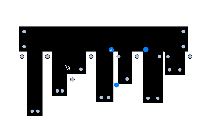

              I did notice the editing nodes in you screenshot are larger than on my system (I now know these can be changed in interface preferences!). I also noticed when tracing over your image the verticals might be slightly off and wondered if this has played a part in highlighting the issue in this instance.0_1635411631540_Screenshot 2021-10-28 at 09.58.05.png

                @Jono It was a bunch of random rectangles merged together. Currently, I have a problem reproducing this error myself. Then I repeated this bug several times. Fortunately, restarting the program usually helps in cases like here.
                Often, instead of turning off the pc, I put it to sleep. Maybe it also has something to do with it
