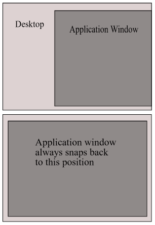

Unintentional behavior of VS Application window
Hi
When I click on the downsize/maximize button
and move the minimized program window to the
right or down, the program window jumps back
to its original position when I click a tool
or just in the canvas.I would like the application window to
remain in the position I moved it to.Picture for Explaning

I will try to replicate on Windows. The way I understand:
- the app is starting in maximized state.
- restore button is pressed (center icon on the top-right side of the window).
- window is moved.
- window jumps after moving.
Are these the steps to replicate?
@vectoradmin
No need to apologize, I added my specification after you has asked.
- window is moved.
Yes, thats how i made it.
But to precise last Point, it jumps only if i make
any Changes in the Program Window
e.g. Select a ToolThe window jumps back after i:
move it and Select a tool
When I select a tool and then
move the window, it jumps when
I create a new object -
When an object is created and then I
move the window the window jumps
back when I move the created object -
and probably for all changes made in
the program window after moving the window.
@Subpath This issue should be fixed in the new build 1.1.002 (beta)
@vectoradmin
thanks for the fix, have had it figure out allready
