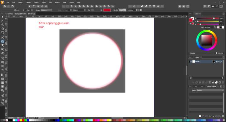

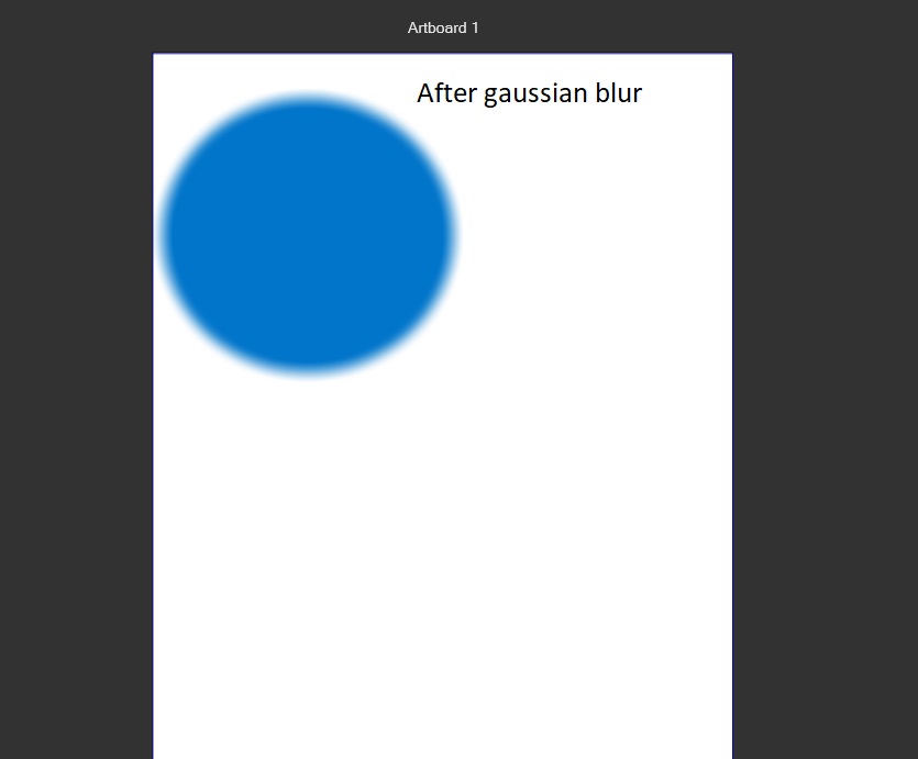

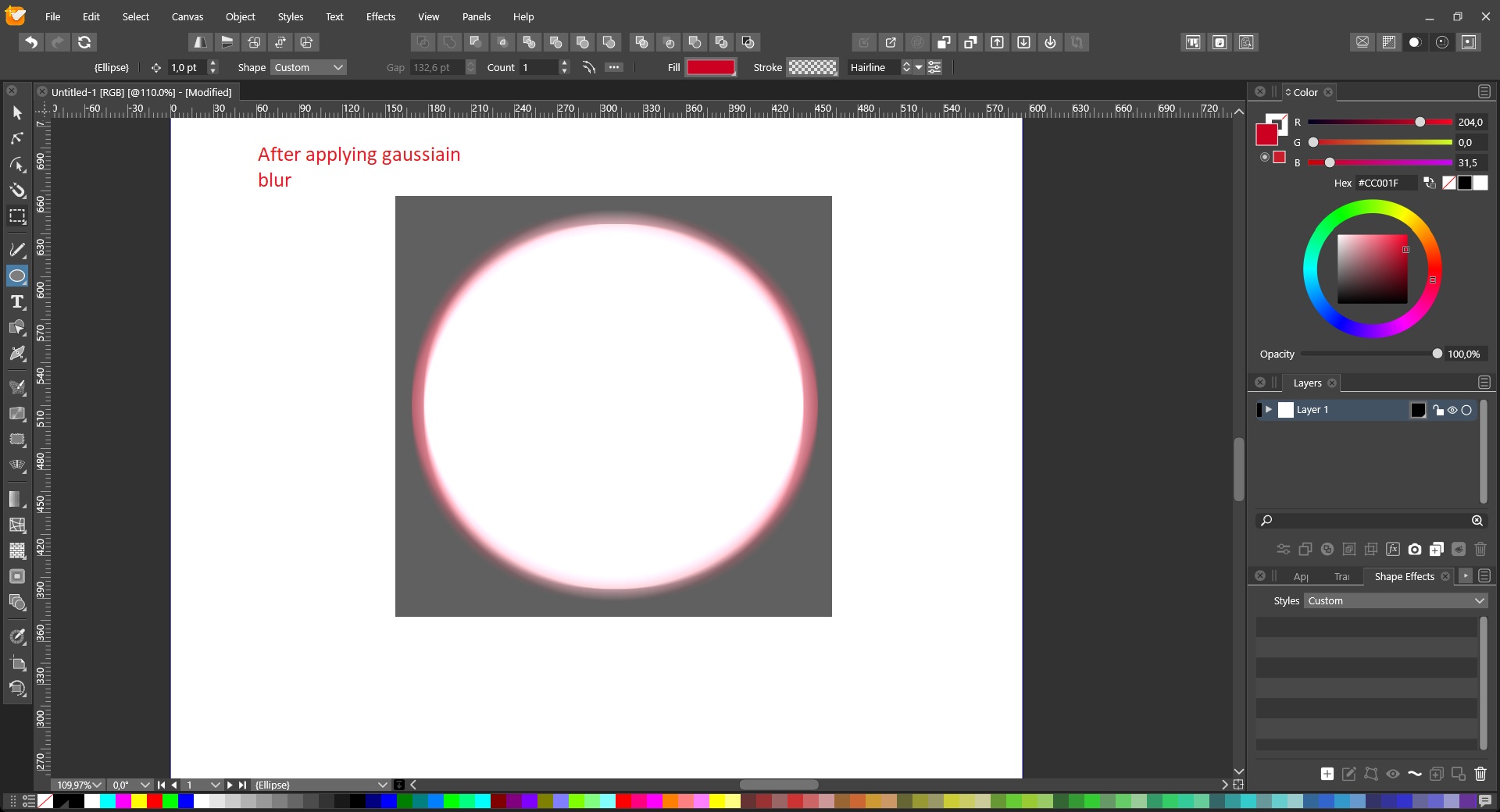

Using the open cl computation method most effects have a grey box surrounding them after the effect is applied
Gaussian blur
I think the grey box is th actual alpha channel , the dropdown shadow also shows the same issues

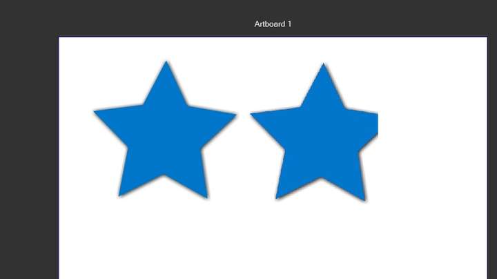

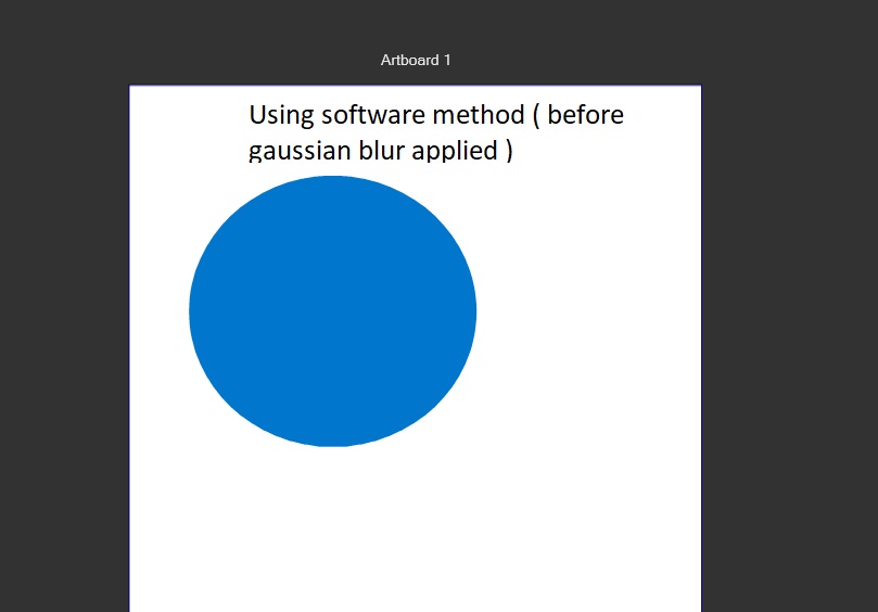

An old amd radeon , which I think is not compatible , but I am using software rendererHere's the shadow dropdown effect applied

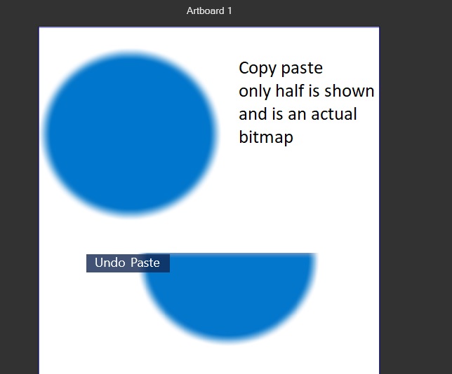

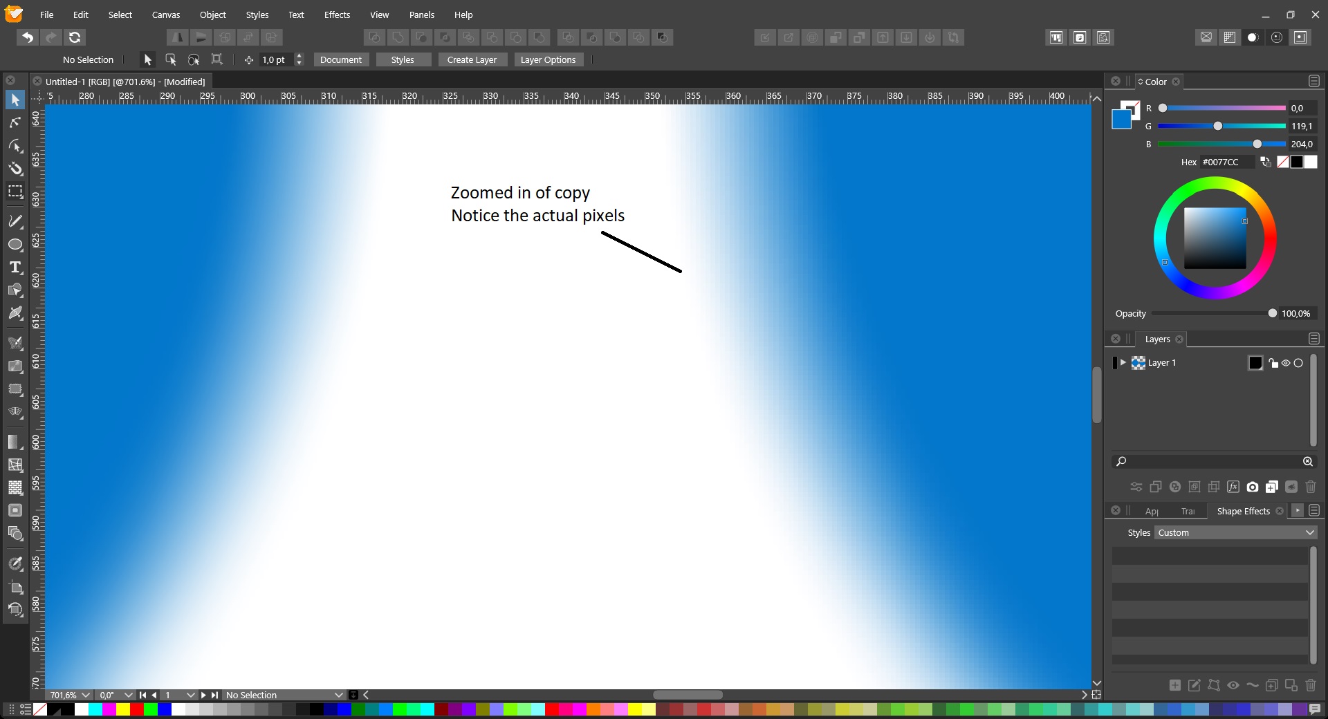

The copy doesn't render completly , and zoomed it looks like a bitmap

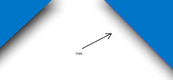

@gentlecl At higher zoom levels, some image effects will render at low resolution. This can be changed using the View -> Display -> Display Options -> Images -> Filter Precision field (50% by default, 100% means full resolution, but blur can be very slow).
Also: do not worry about the preview at high zoom levels, when exporting to image file formats, the filter is rendered at 100% precision.
I am more worried about the partially copied objects , why certain elements are cut off abruptly ., the grey bouding area etc..
As it is now , for me the stylize effects are not usable , maybe it's becasue of the gpu hardware incompatibility ?
