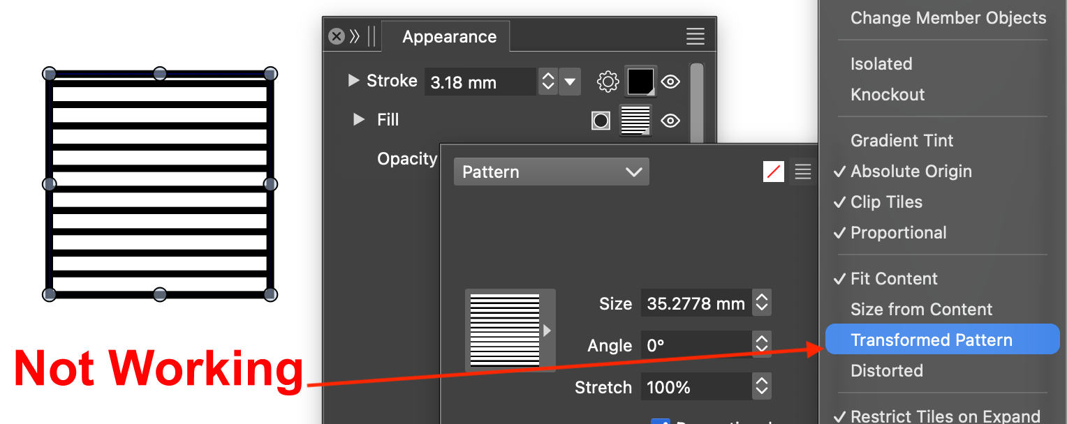

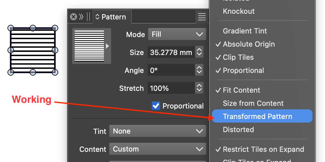

Transformed Pattern option not working outside of Pattern panel

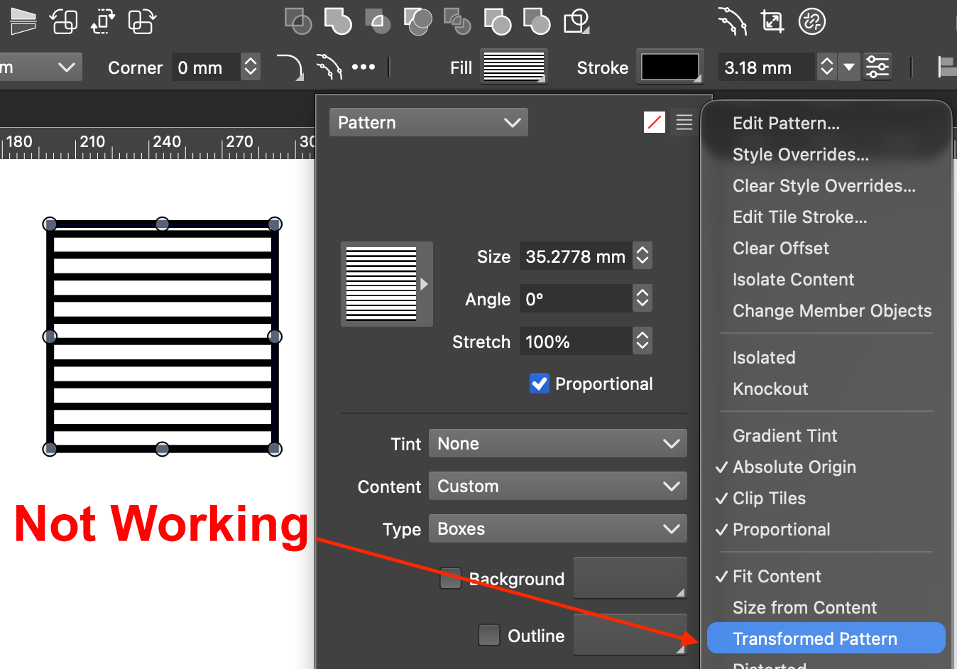

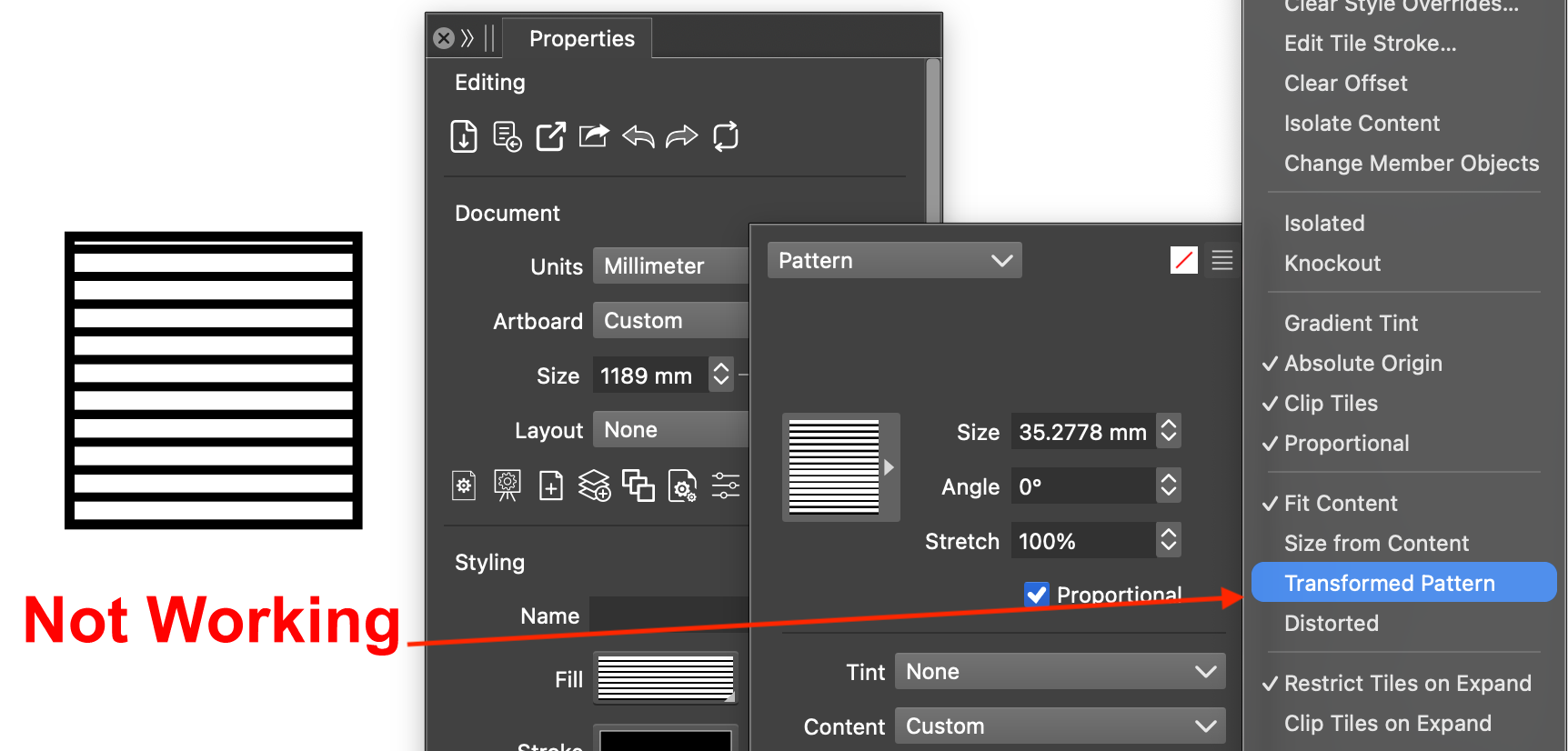

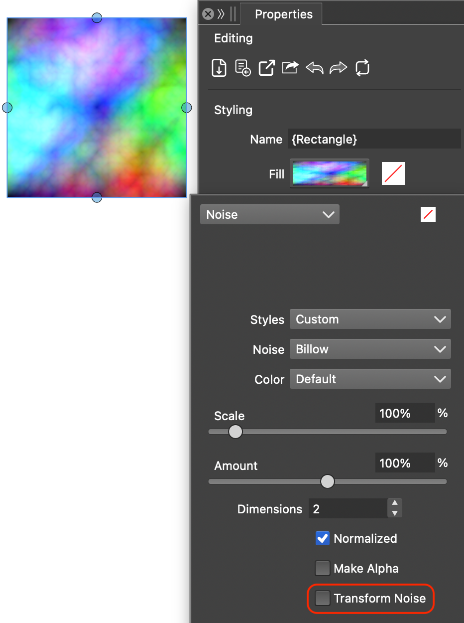

Only the 'Transformed Pattern' option in the Pattern panel works; the same option in the Properties panel, Context panel, and Appearance panel is ineffective
@vectorstyler The 'Transform Noise' option does not work across all panels
@Li-Xiao These are bugs, I will try to fix them
@VectorStyler 'Transformed Pattern' is completely fixed now. However, 'Transform Noise' is still not working.
Found a new bug with Pattern fills in version 1.3.032, except for the Pattern panel which still works, using any of the other panels (Properties panel, Context panel, Appearance panel) causes a crash. Version 1.3.031 had no issues.

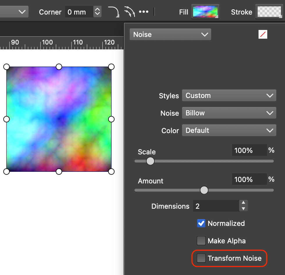

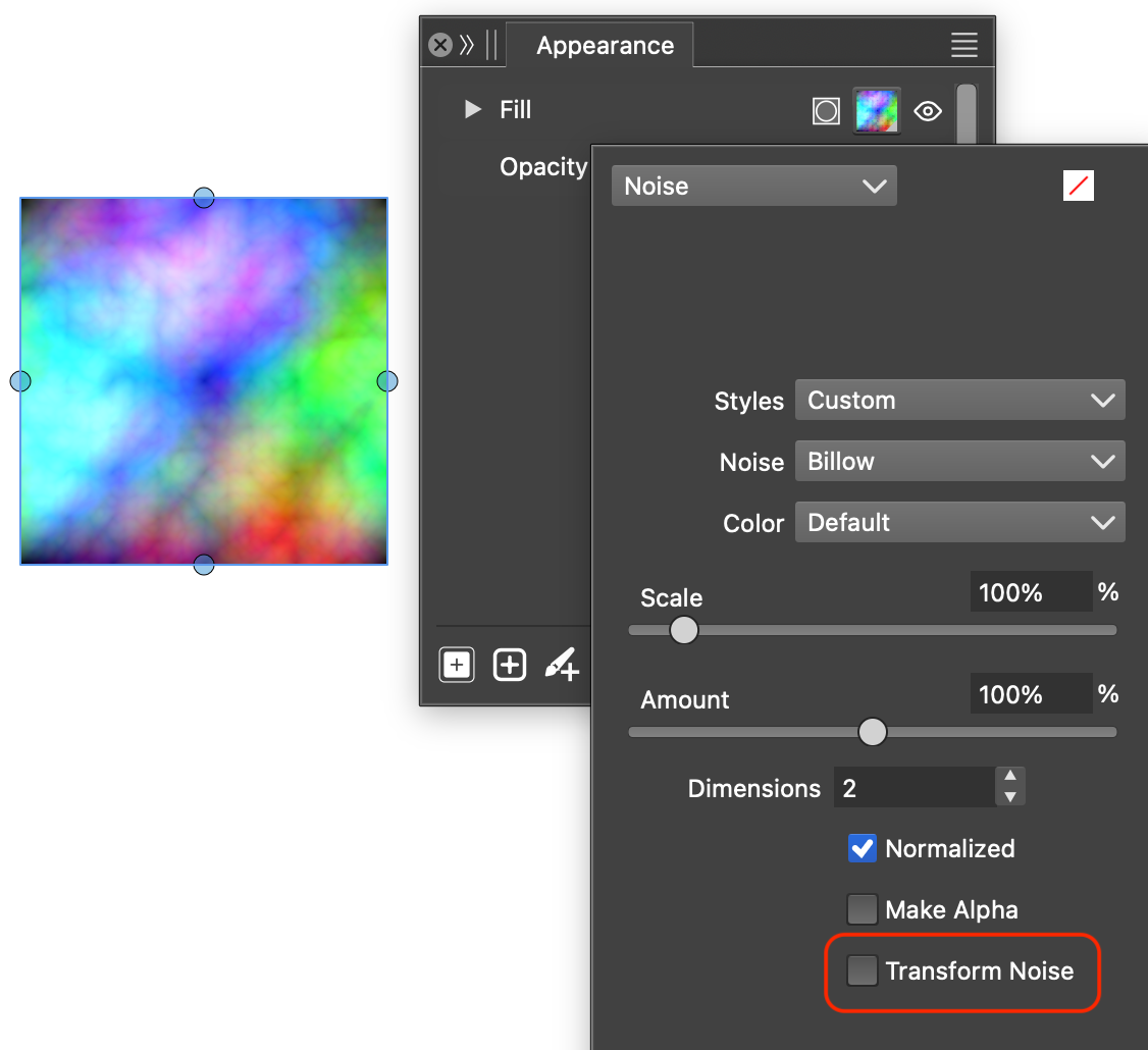

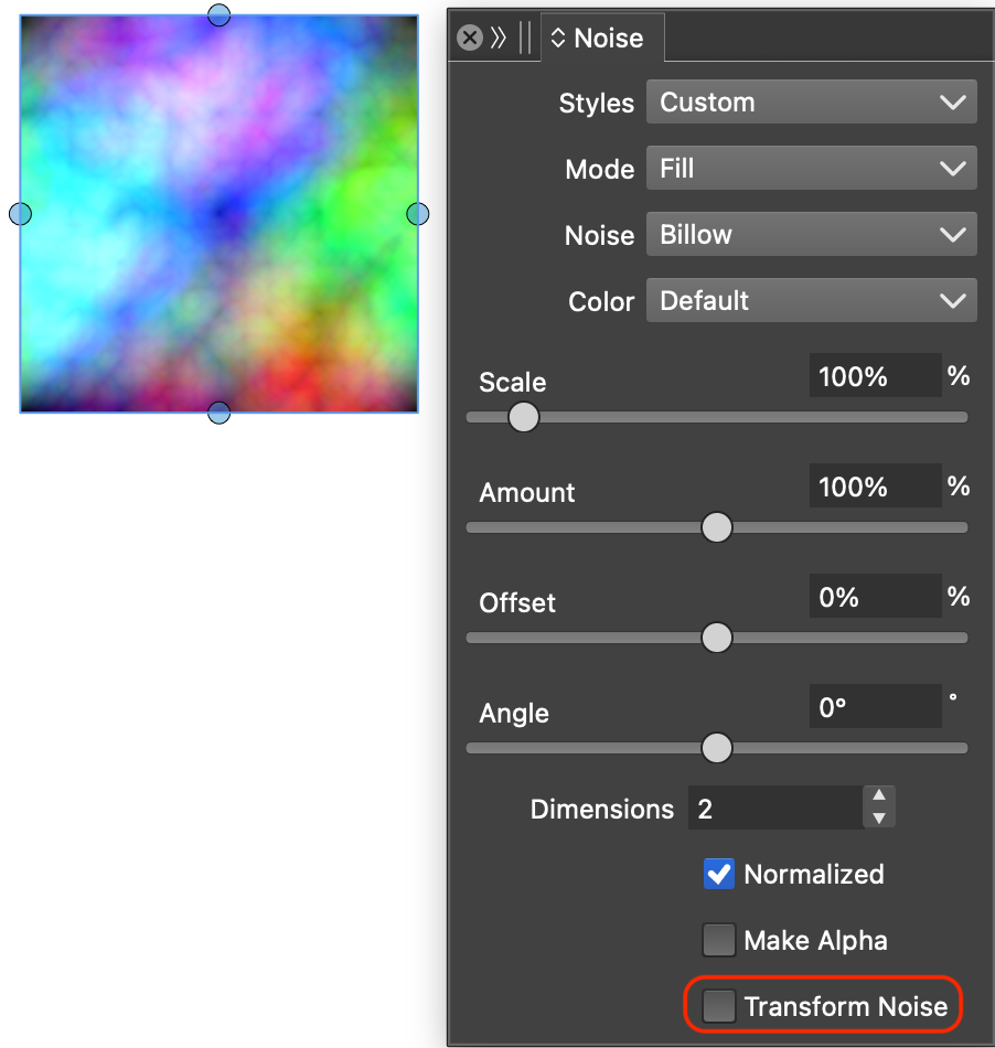

@Li-Xiao said in Transformed Pattern option not working outside of Pattern panel:
After testing version 1.3.032, 'Transform Noise' is broken across all panels.
This kis not really a bug, the problem is that transform nose is not working with default noise options. You have to edit the Noise properties and change the Positioning mode (top-right corner of the nose options view).
I tried restoring defaults, deleting the workspace, and doing a full reinstall, but still no luck. It happens on both of my computers.
please check the video.
@Li-Xiao Send me that file in the recording (saved after the Transformed Noise is set)
After saving the file, restarting the app, and reopening it, the Noise panel works fine now, but all the other panels still have issues.
