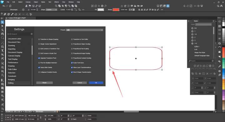

@VectorStyler The outline effect is fine. I just realized I accidentally turned off the eye icon while operating.
By the way, could you help me figure out why this function in my workspace isn’t working?
