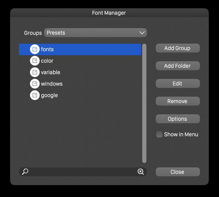

    One way to work around these is to create a folder with these fonts, and then add that folder in the Text -> Font Manger menu. VS can access fonts from any folder, even if not installed into the system.

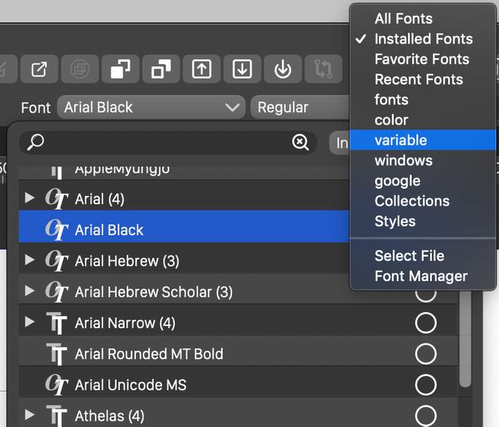

    @Arde Fonts added with the VS Font Manager, show up in different font groups. In the font selector list, there is a drop down menu in the upper right corner. This shows Installed Fonts by default. Try selecting the font folder name (that was added in then VS Font Manager) here.
    The fonts are organized in groups.

    The fonts added in this way are accessed by selecting the font collection (folder) name in drop down on the upper right corner of the the font list.
    In this example, the VS font manager points to 5 different font folders, that were selected using the Add Folder button.
    These will be shown as separate font collections in the font popover, and to select a font from one of these collections, the collection must be selected first (see below).
    To access a collection, click on the Installed Fonts button on the upper-right corner of the font list popover.
