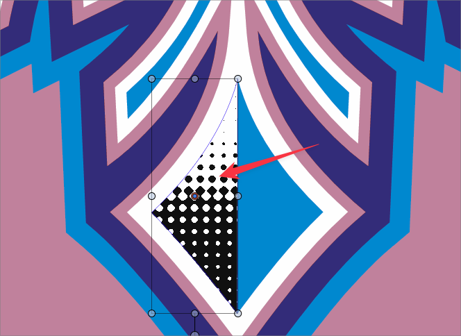

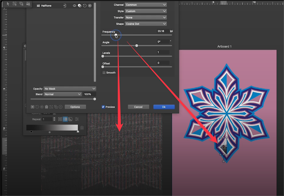

Bug issue first - I noticed that if I adjust the scaling of a gradient I have used pixelate>halftone to convert to glorified halftones, it causes images pasted into the file to go wonky. You can see this in the video here

The part of the thread conversation I was most interested in was gaining the ability to image trace a raster effect created in the design itself (in this case, a pixelated halftone)

@Boldline I roughly know the reason for the effect of your video. You should have used GPU rendering and set it to default software rendering. I have encountered this issue before.
@Boldline I could not replicate the images going wonky problem. I opened a bug on this and will try it on a Mac M1.
Would it help if I cause the issue to occur again and then save it after that point and send it like that to you?
@Boldline said in Raster images embedded go wonky when the "frequency slider is used in the Image Effect panel -also could we image trace an image effect with image trace?:
Send me the settings/workspace files by email. This seems to be a display issue. But yes, save the file and send that to me also
